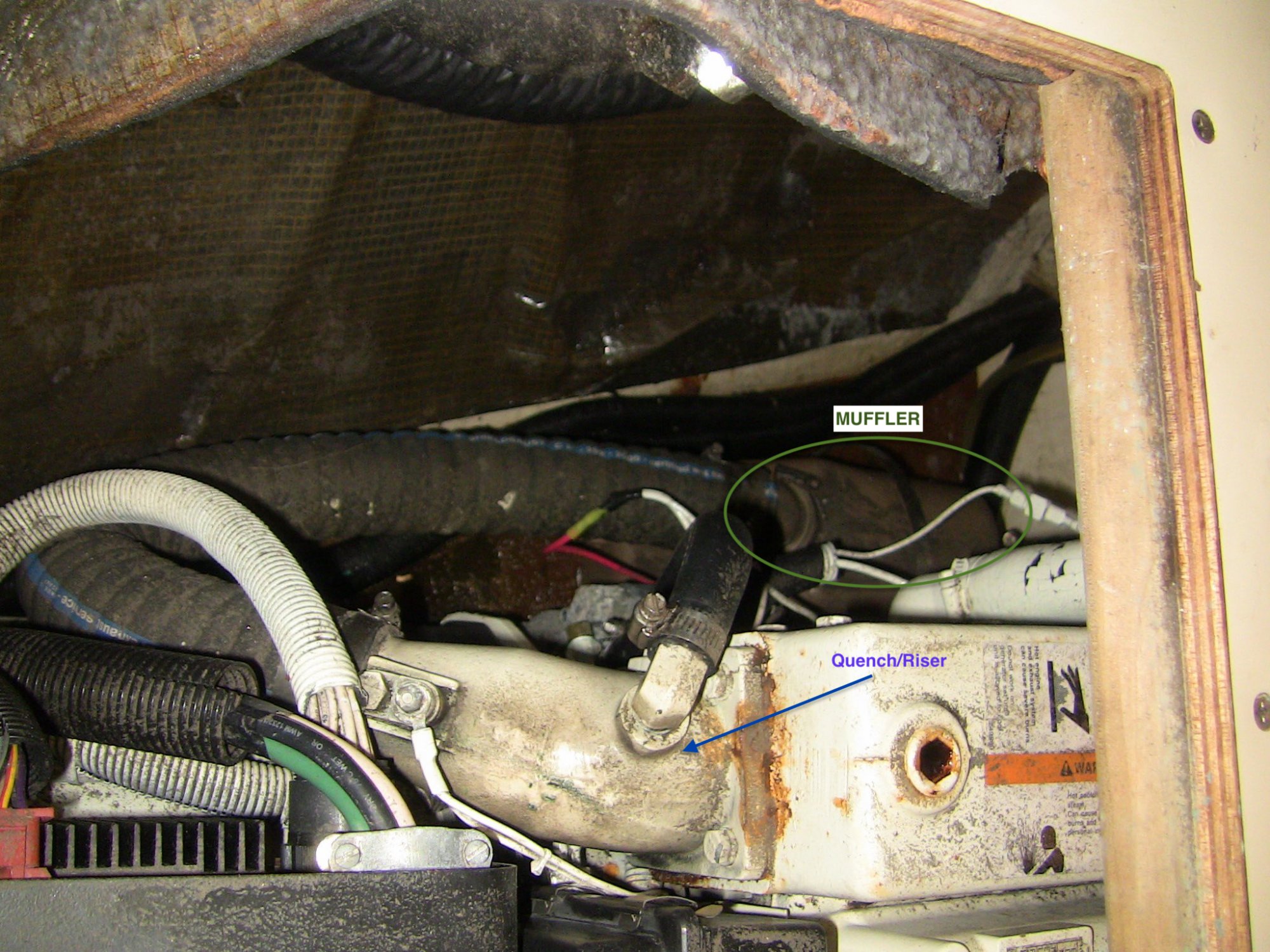

Here is a picture of mine that was dunked for 10 minutes from Hurricane damage. I will get a new one by insurance.;)
So ignore the dirty state...
The Muffler is not a big thing, but hard to disconnect and clean.
You might Disconnect the hose at Riser and run a endoscope camera to see inside it, or disconnect that Loop and flush the Muffler clean with water hose.
