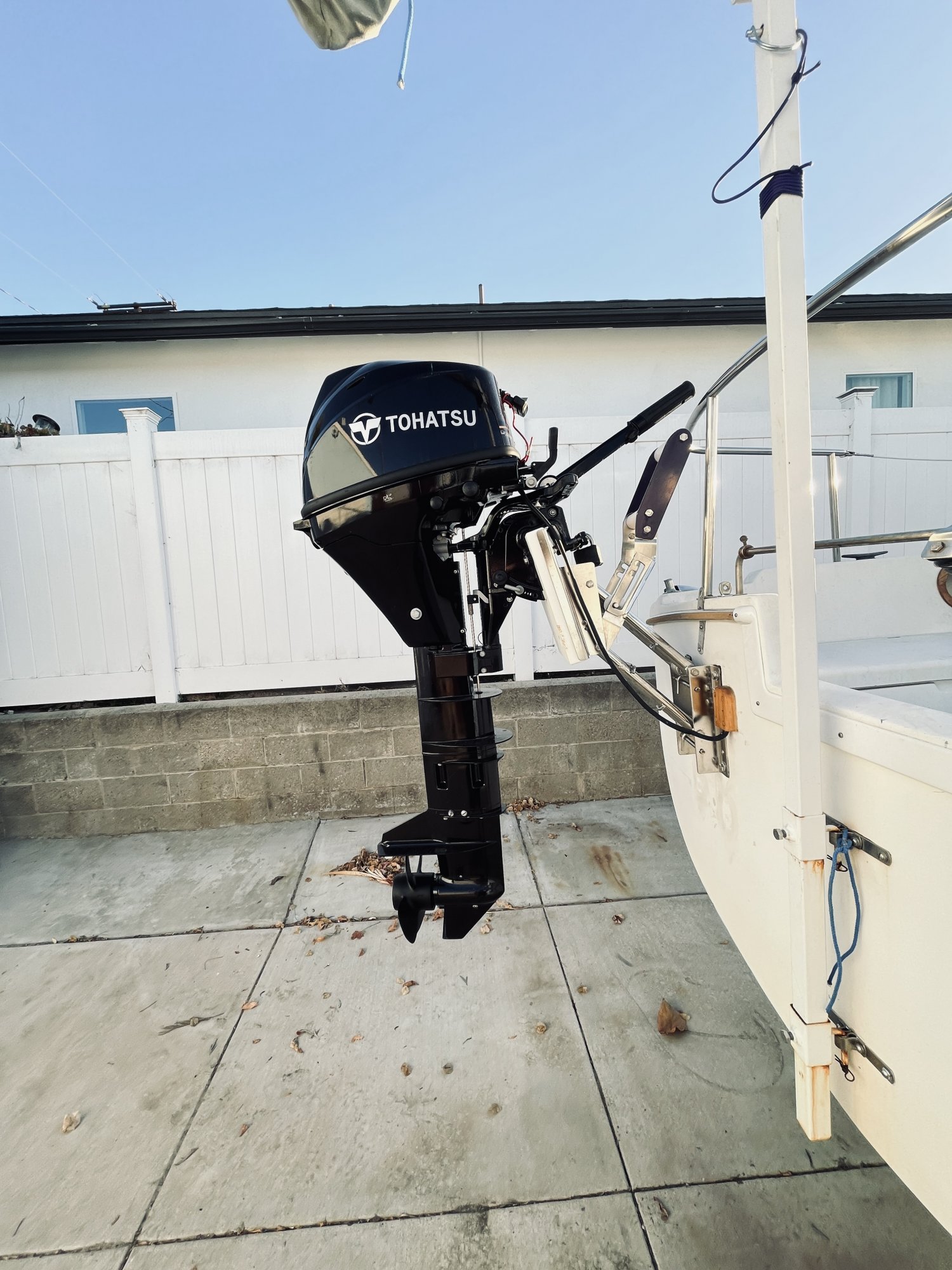

I have the Tohatsu 9.9 on my Catalina 22. I love it I have the 25” shaft and a catalina direct 3 spring outboard mount for it. The motor weighs in at 95 pounds so the 3 spring mount is needed. I looked at a lot of mounts before I bought the Catalina direct one, I am super happy with the mount too. I did add an extension to the handle to make it easier to get the motor down all the way into the water. The handle extension is the purple part of the handle.
I sail in the pacific ocean around Oxnard and Ventura a little north of LA. Afternoons coming back from Anacapa or Santa Cruz Islands can get a little rough. The 25” shaft keeps the prop in the water. My previous 20” shafted outboard did not and sometimes came out of the water on rougher days
A plus is it is electric start, which my wife likes and it keeps my battery charged on longer runs. The motor ran great right out of the box with a little carb adjustment for idle once past breakin. It has been a great motor. Since I never run it past the Turtle setting on the throttle I get mileage the is only a little less than the 6 horse Tohatsu I had. It pushes my Cat 22 to 5-5.5 Knots or so at that setting. Feel free ask more questions if you have them.

As Stu Jackson suggested I did use a piece of plywood to reinforce the transom. I also had to work out new weight and balance to get the required tongue weight when towing. I added extra batteries under the v-birth and added some weight to the front of the trailer in an ammo can bolted to the trailer near the tongue. I hate to add weight to the trailer but it was the only option I could come up with. The weight in the can is about 50#. This makes it possible to trailer with the motor attached. My motor is the Tohatsu 9.9 Sail Pro purchased new in 2021. It has a carb and about 150 hours on it with no issues.
