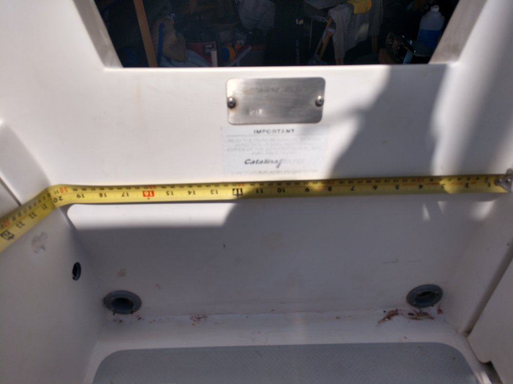

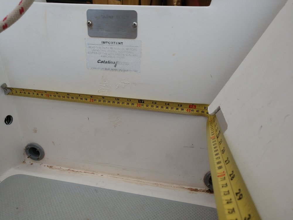

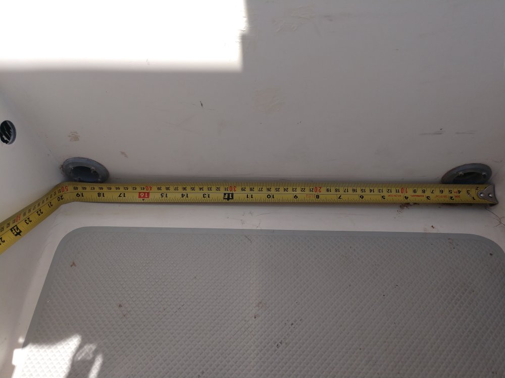

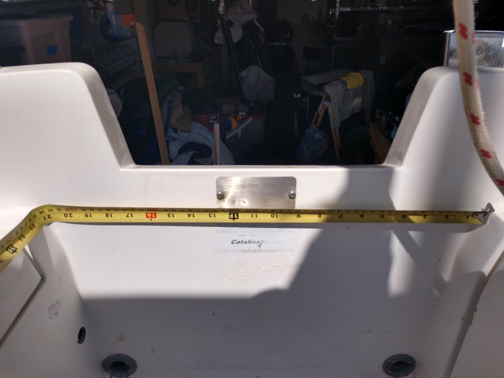

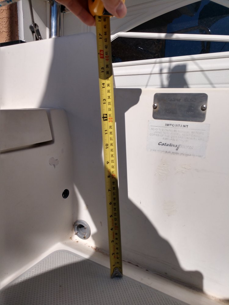

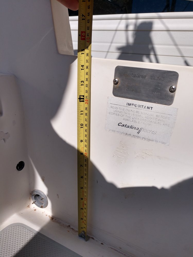

My 22 "Minnie" is currently 3 hrs north of me in Channel Islands harbor and I need a measurement of the inside of the cockpit at the back of the stern under the traveler between the storage and gas lazarettos. Anyone near their boats that could help me out I would be in your debt. I am trying to work out my extra fuel bottle issue and need the measurements to do it.

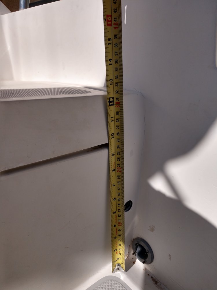

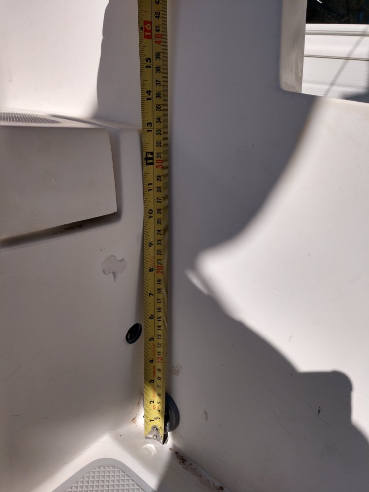

The trough below the scuppers makes it a bit challenging to measure. The trough looks to be close to 3/4" deeper than the cockpit floor. The perspective in some of the pictures also makes it a bit challenging to read, but the cockpit floor to the opening is almost exactly 14".

The storage locker looks like it comes in 1/4" or so on its way up -- but that 1/4" is entirely within the chamfer on the top ~3" below the seat. When swinging the gas locker open (at approximate apex), it looks like there's safely 16.5" between the locker door and opposite wall.
