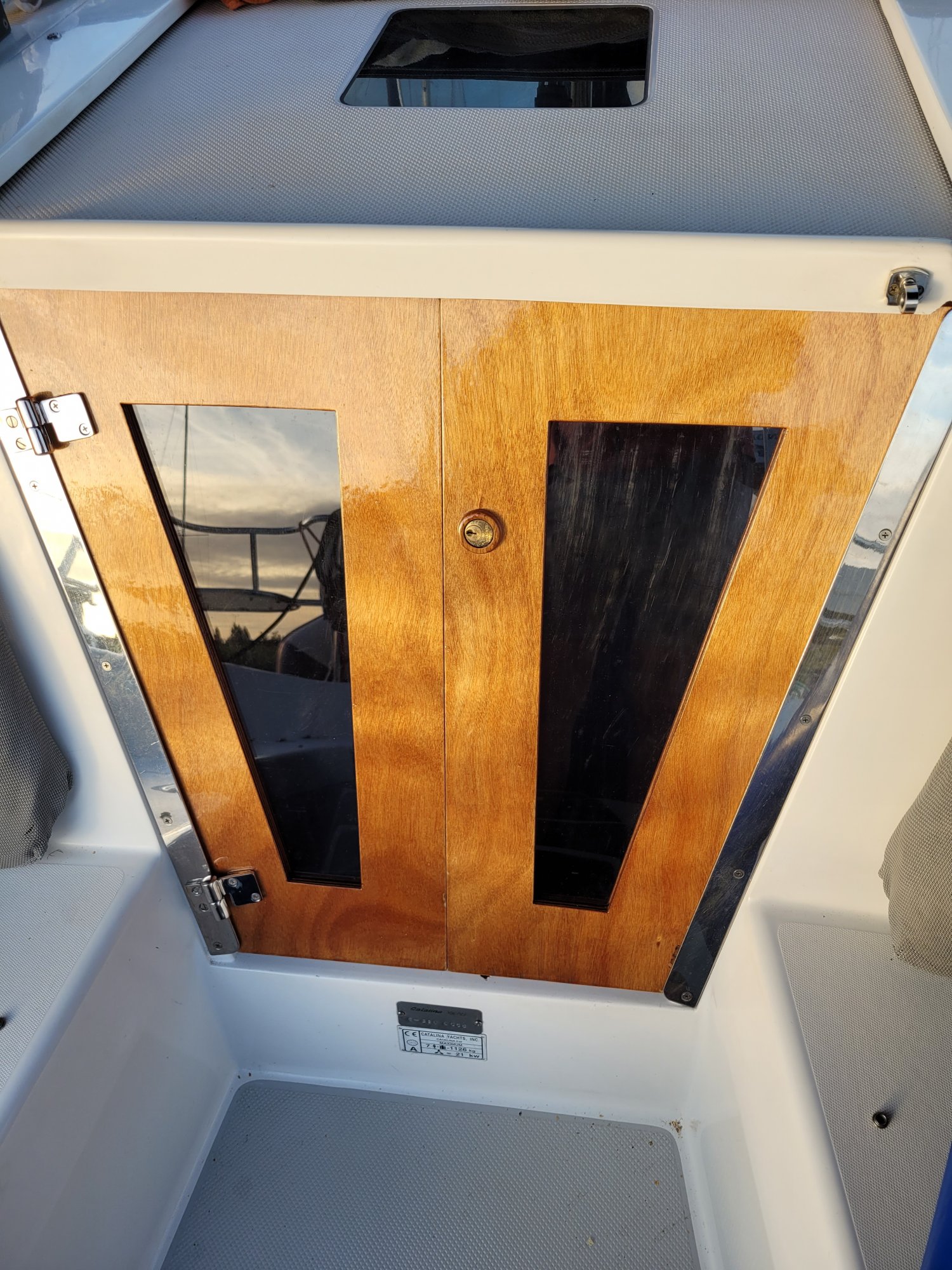

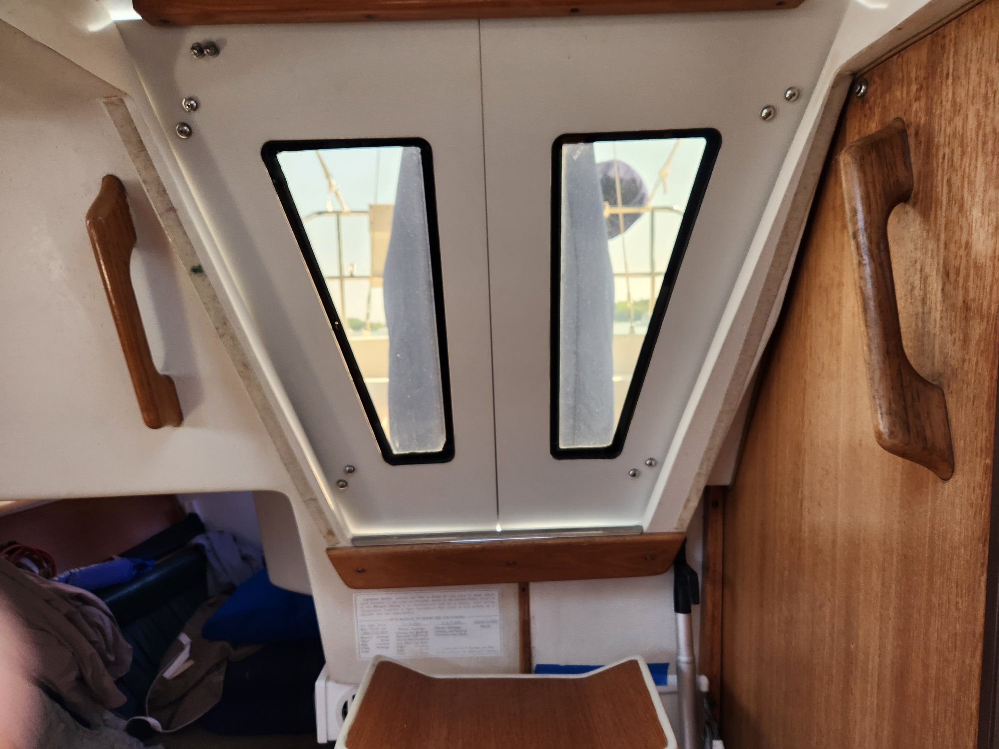

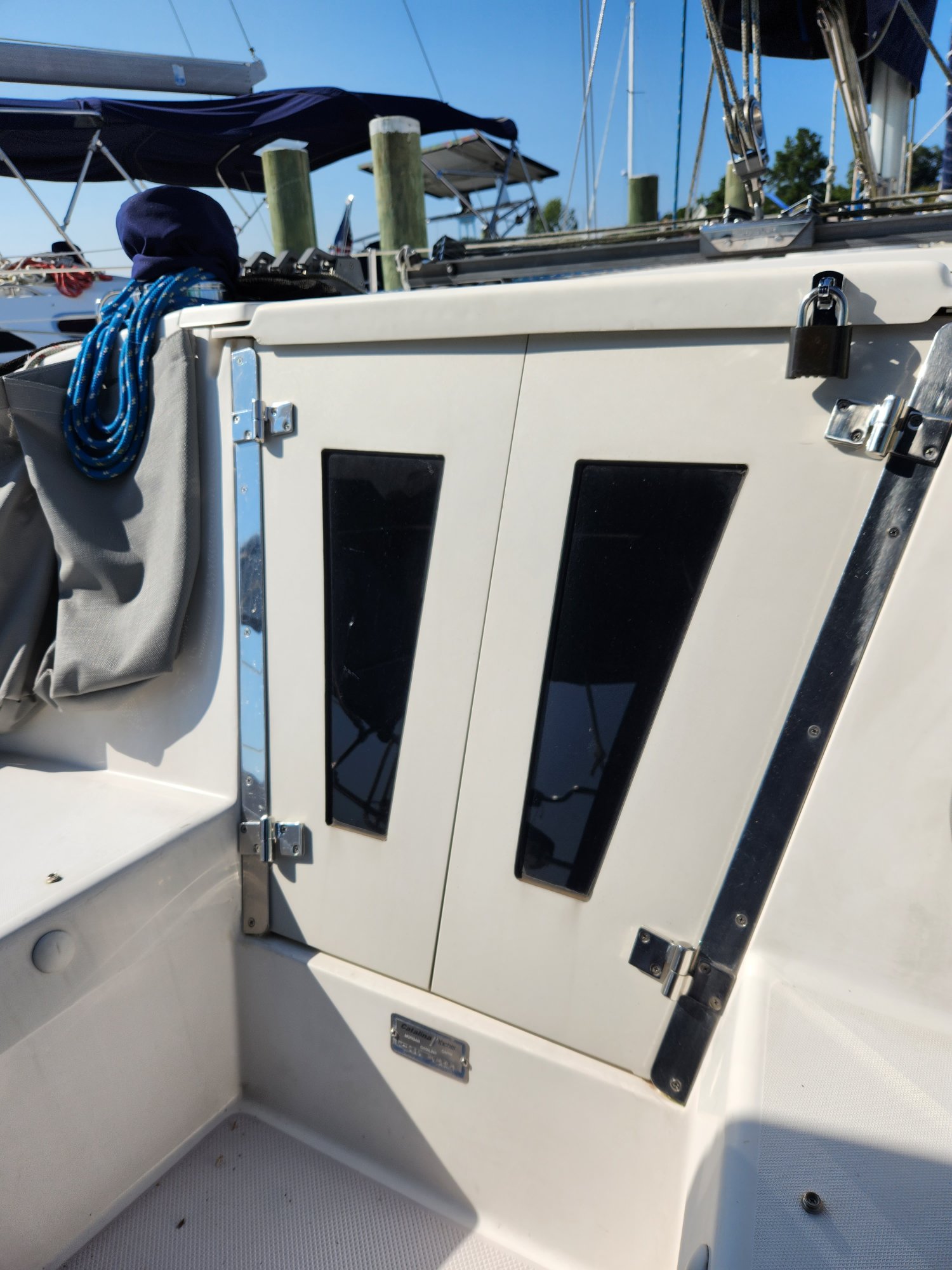

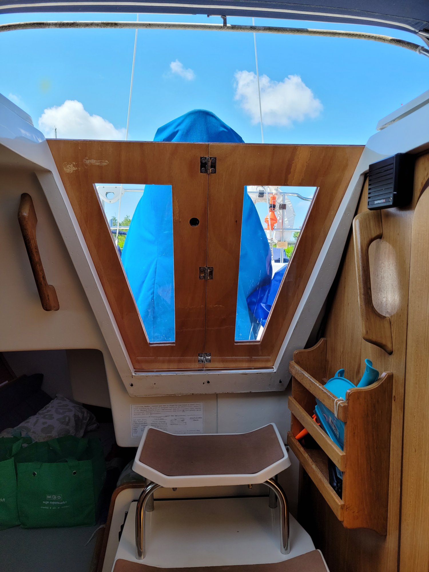

Last winter i made a set of doors, The sliding boards are gone! So much easy opening/closing.

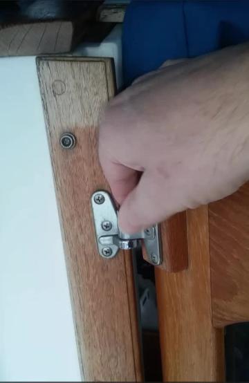

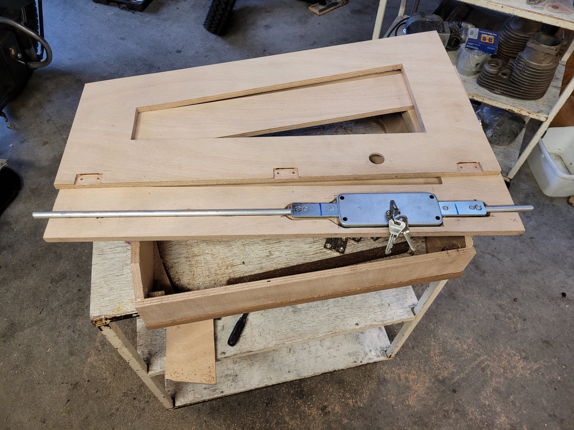

it has a garage door lock build in, a no lose lock needed. The windows can be changed with screens.
finally i found the perfect place for storage when sailing.
john.

Very nice. Where do you store the screen panels? My screens suffer a lot from my abuse.

Really nice! Very innovative lock mechanism. I have intentions to fabricate a set of removable doors; however, it's at the bottom of the priority list!:waycool:

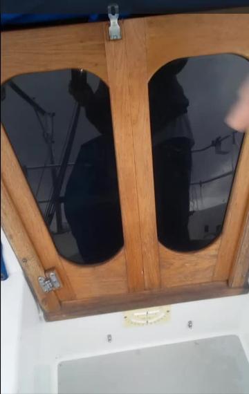

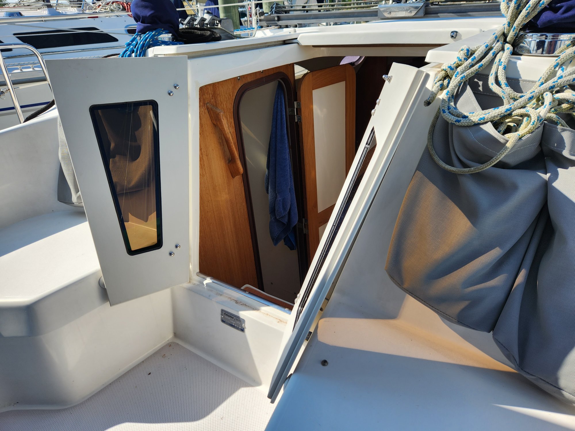

I prefer the bifold doors to seperate doors. So much easier to just fold the door away. On My C30 the bifold doors have captive hinges with spring mounted pins so that they cannot come loose unless you pull up on the knerled knob to release the pin. They also fit into the oringinal hatch board track so that I can install the old drop boards for winter and keep the pretty ones at home.

Thank you for sharing your projects. Both are very nice. I'm impressed that the doors can hang between the engine cover and the wall of the head.

Here is a video of my bifold doors. Note that they use the original drop boark slides so they can be replaced with the boards for storage without modification.
The hinges are captive quick release.

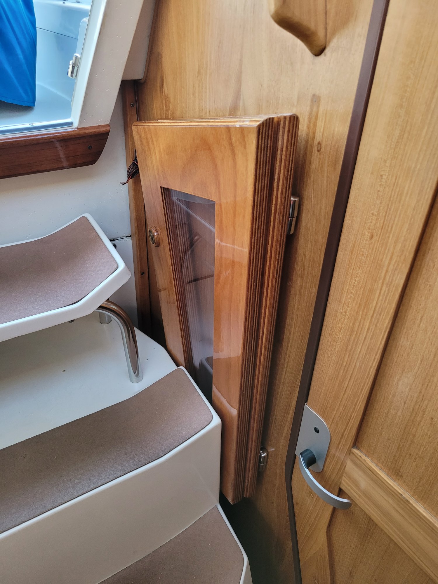

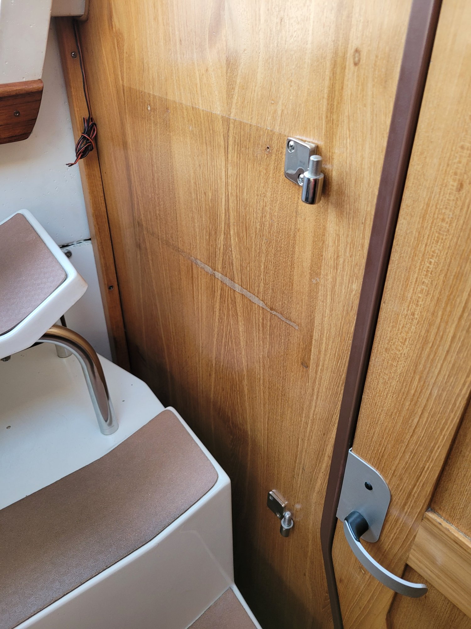

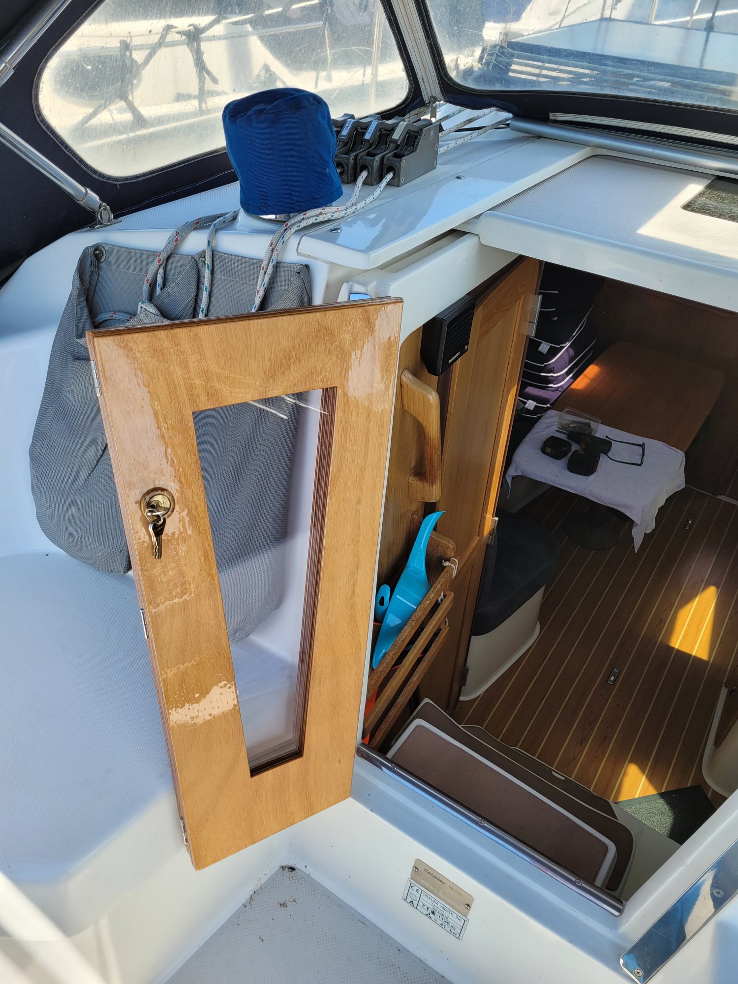

thanks, there are more ways to go. after the summer holiday storing the doors on the v-berth bed. i tried if they would fit there.
A simple sponge keeps the doors free from the engine cover
The old boards are still usable in winter storage.
The locking hinges are a good idea. our opened doors can jump out when heeling over.
