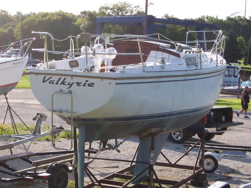

Hey all,
I've owned and raced dinghies, and crewed on keelboats for 20 years. Getting my first keelboat of my own next week- 1985 Catalina 30, standard rig.
It will be berthed on San Francisco Bay, and hopefully we will enjoy many years of happy cruising and an occasional beer-can race!
I'm sure I'll have a ton of questions with this being my first keel boat...

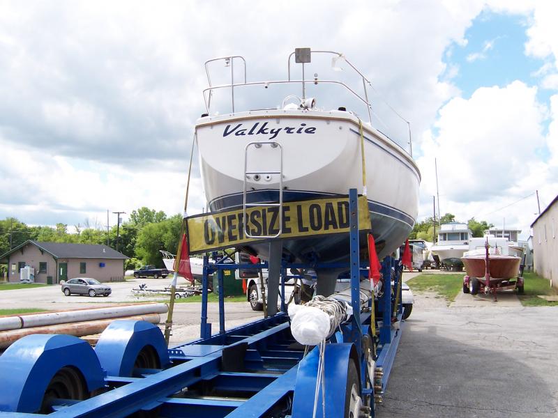

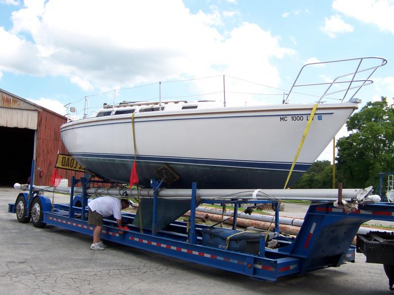

Thanks.
The boat is being shipped from Michigan to California next week. It's from a family member, so I'm getting a very very good deal on the boat. It looks to be in great shape, although I'm a little worried about the engine because it hasn't been started in 4 years (she's been on the hard...)
