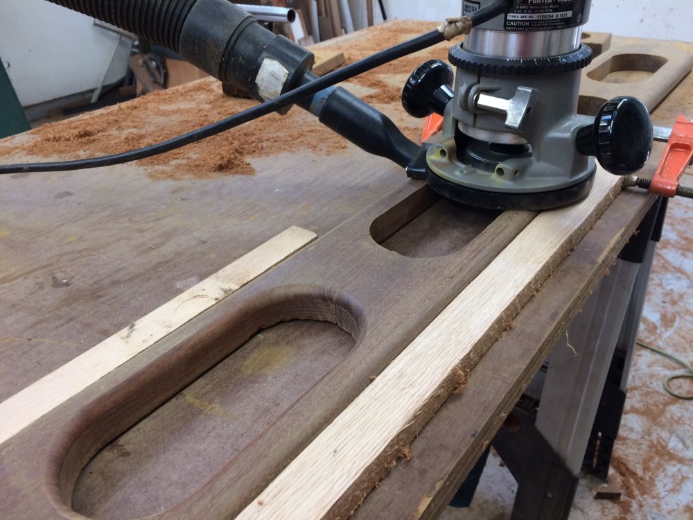

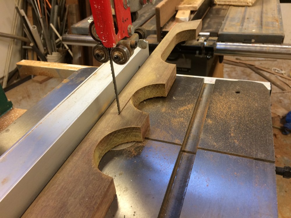

Here is a photo-essay of the project:

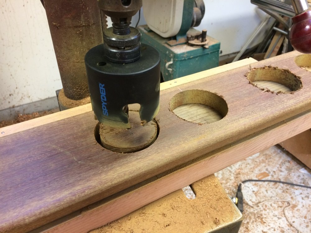

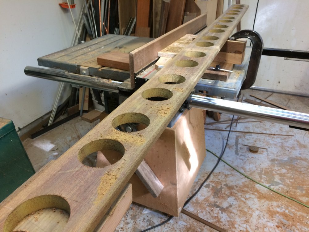

After doing an Autocad layout a bunch of 3" holes - 24 total. The carbide Spyder bit cut a but rougher than my normal hole saws but did have the advantage the the large gullet for each tooth allowed the sawdust to come out. The first experimental cut with a regular steel hole saw took about 10 in/outs to clean the teeth. Ipe is very abrasive and the saw was a bit dull after just one hole. The outer edge of this piece was beveled on the ends and a 1/2" round-over on the router table made what will be the rounded top.
Holes done.

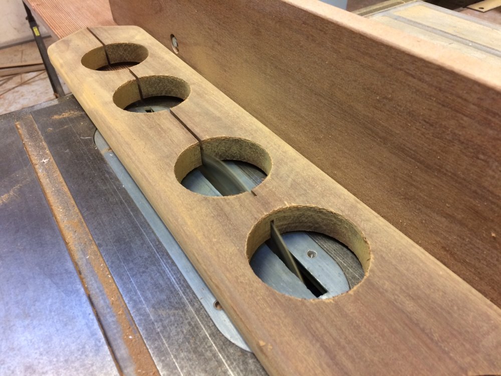

Cut in half.
It had to be cut open to be able to open the spans with a bandsaw. Internal mantra - "Don't let your brain wander and cut the wrong place." Repeat continuously.

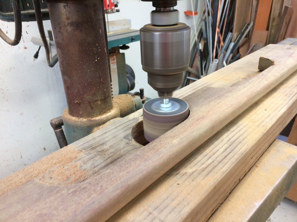

Some work with the drum sander.
