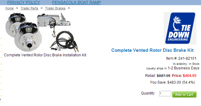

I looked at SS brakes but they were MUCH more expensive. I paid $404 plus shipping from PBSboatstore.com

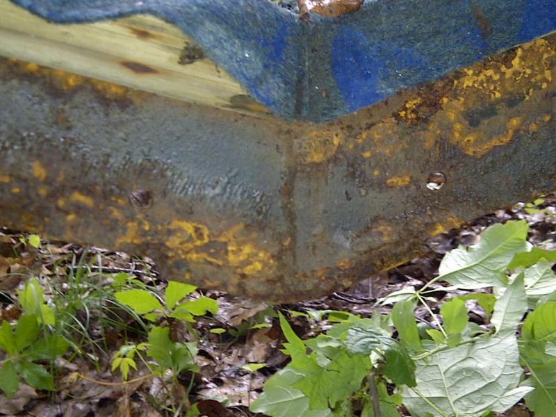

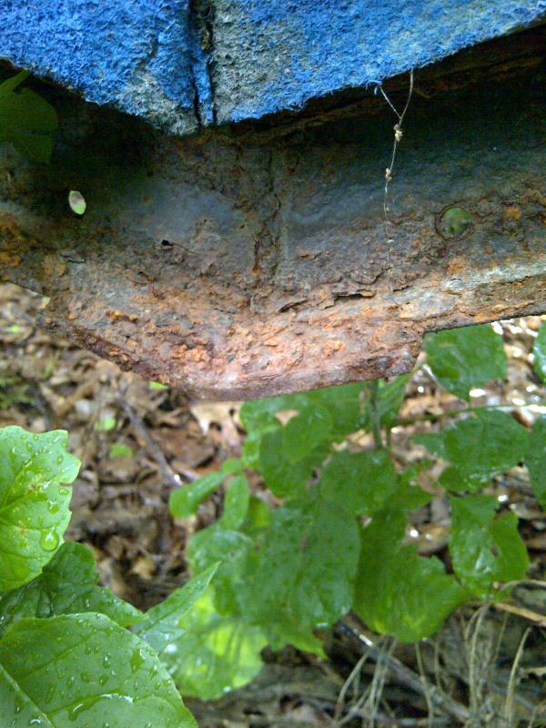

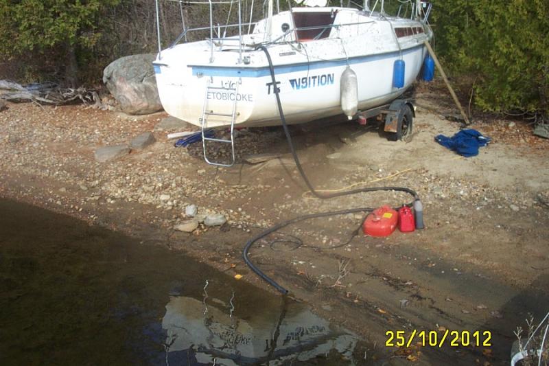

I picked up a "new boat" (88 Mac26D) this spring. It had sat on it's stock trailer (no beaks) half in the water, for the last 8 years! In Canada the water gets really hard in winter!
When a buddy pulled it out he inflated the tires and greased the Bearing Buddies. Then drove 200km home! Stopping every 20k or so, then every 50k. The bearings didn't get hot! (I had sent him a new set of hubs with nuts and bearings just in-case.... 8 years submerged in fresh water!)
I picked it up from his place, changed the tires and added grease. Then drove almost 400 km home. Stopped twice for coffee and the bearings were fine. (They did throw some grease onto the hull but I think I over filled them.)
I can't say enough good about Bearing Buddies!
I am yet to pull the hubs as I plan a new axle with disc breaks next spring. I will document the bearings and hubs when I do.
Here is a pic or two of the boat ware it sat for 8 years. The water is down for the first time in over 10 years for dam construction on the Trent Severn. (If it wasn't it would have been a different job getting it out.)
Did I mention Bearing Buddies?
Nov 23, 2011
2,023
MacGregor 26D London Ontario Canada
RDS: Huh?
PM me and I'll give you the whole story.
Yea. PO said 8 years. (She got it in the divorce along with the cottage. It was his. She didn't touch it for 8 years. It sat with the sails on it right ware it is in the pic above! The main and Subrella cover were pooched along with the furled jib.) She had the place landscaped and removed the only access tow it out! That's a grudge!
My buddy used the neighbors access to get it out.

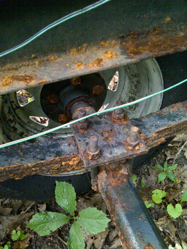

I'll get some good pictures of the trailer some time soon. The rust development (Bubbles up like a pimple.) looks to me like it was submerged.

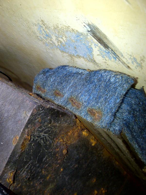

Here is a picture of the front port bunk.
In the above pic, the stuff on the cabin top is moss.

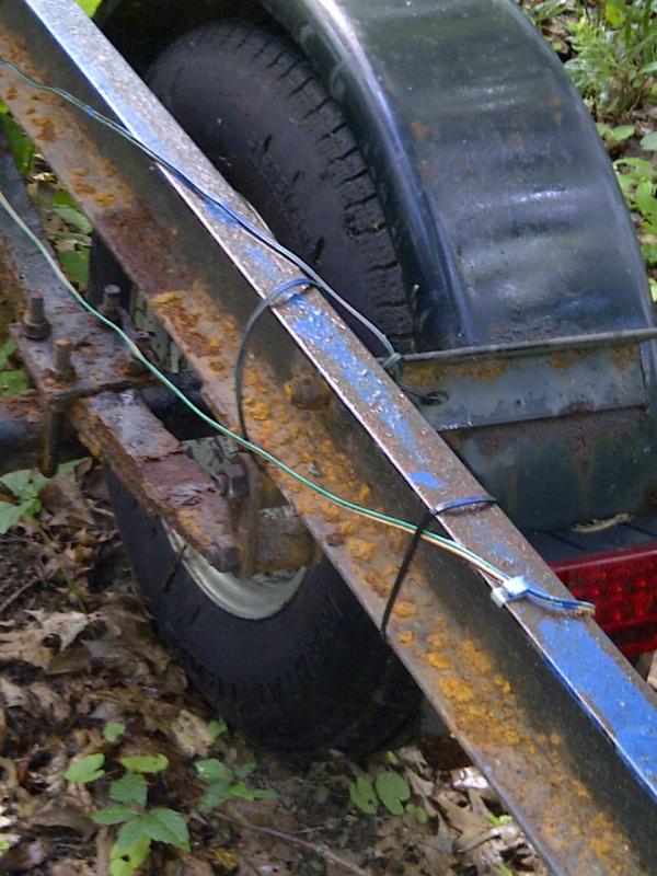

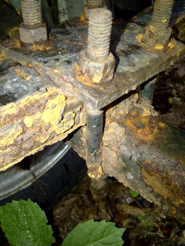

Nov 23, 2011
2,023

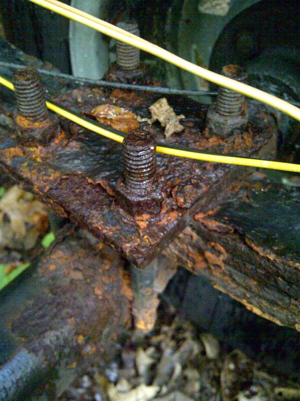

My rusty trailer. If this had had any type of breaks it never would have moved.
The last picture shows how much grease was thrown out onto that rim during my 4 hour drive home. The other side did the same. The lug bolts look particularly rusty.
