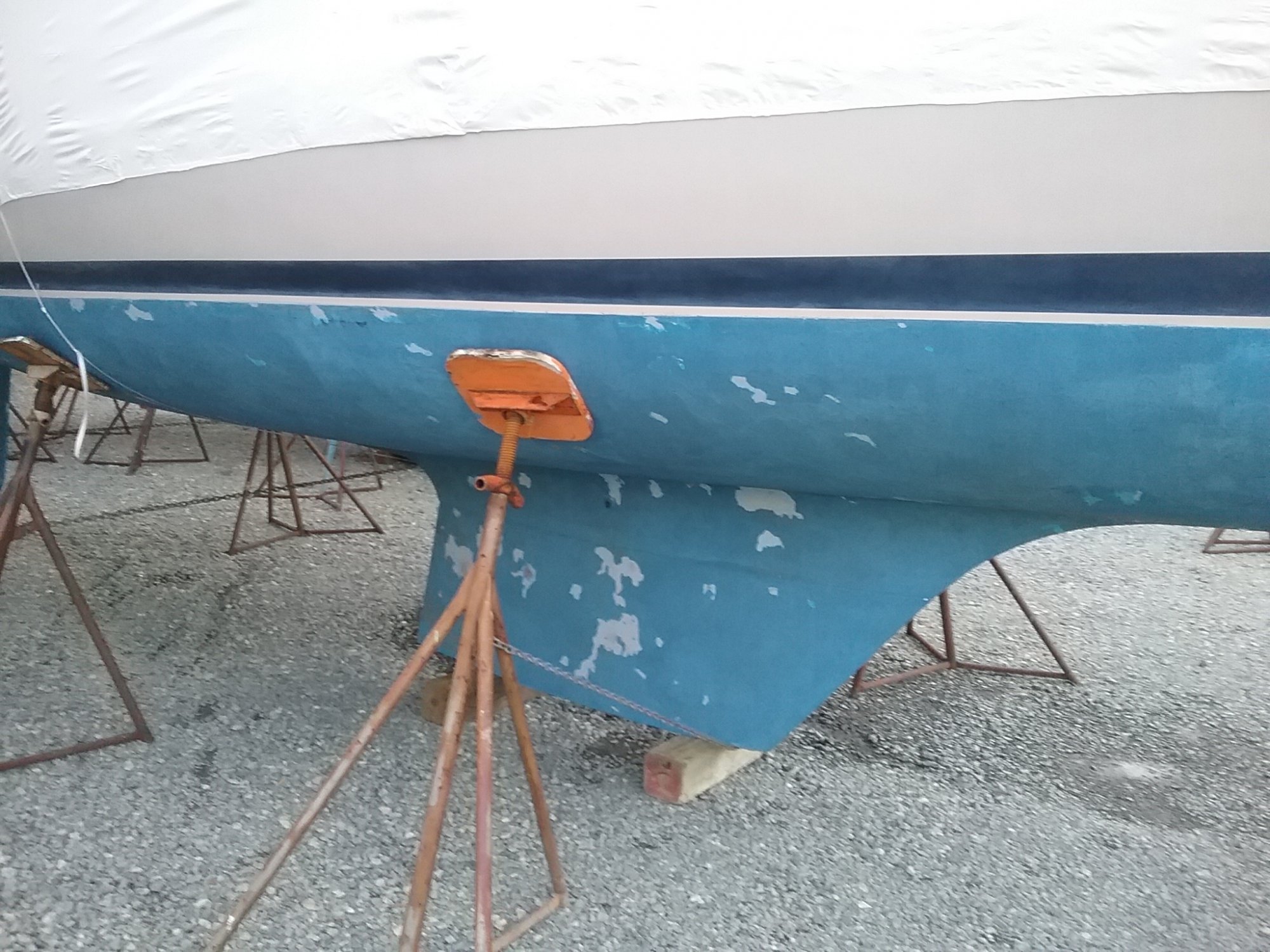

This is the appreance of our hull every time she is hauled in the fall. Usually we power sand the bare areas, apply one cost then another coat over the whole bottom. The bottom paint is Pettit Hydrocoat and she has barrier coats. No blisters have been found. This will be our seventh season and I would like a more permanet solution. She could be soda blasted or chemical stripped. However I would like to avoid the application complexities of adding more barrier coats. Could a primer be used over the existing barrier coats before reapplying new bottom.

Hydrocoat works great to keep barnacles and slime off but there are patches where new and old coats come with the pressure washing during fall haul out. I suspect po waited too long to apply bottom paint after barrier coats.

Hi Larry, My Catalina has the same problem and I suspect the same cause as you do.
i’ve been wiping down the bare spots with acetone/thinner before applying bottom paint. Seems to help. On my boat the loose paint/bare spots are mostly where the thickest paint is letting loose and are fewer each year. Hoping in another couple of years the thickest paint is gone, will save me the cost of having the bottom blasted clean.
This will be my 4th season using Hydrocoat. It has been working well here but the local shop reports a lot of boaters are happy switching over to Seahawk Monterey for the 25% cost savings.
Sep 23, 2009
1,476
Patches seem to be different random spots every year. I sand bear spots with 80 grit, apply one coat over bare spots then one coat over entire bottom. Soda blasting would be about 1700 but biggest headache for me would be two new barrier coats and timing of applications.

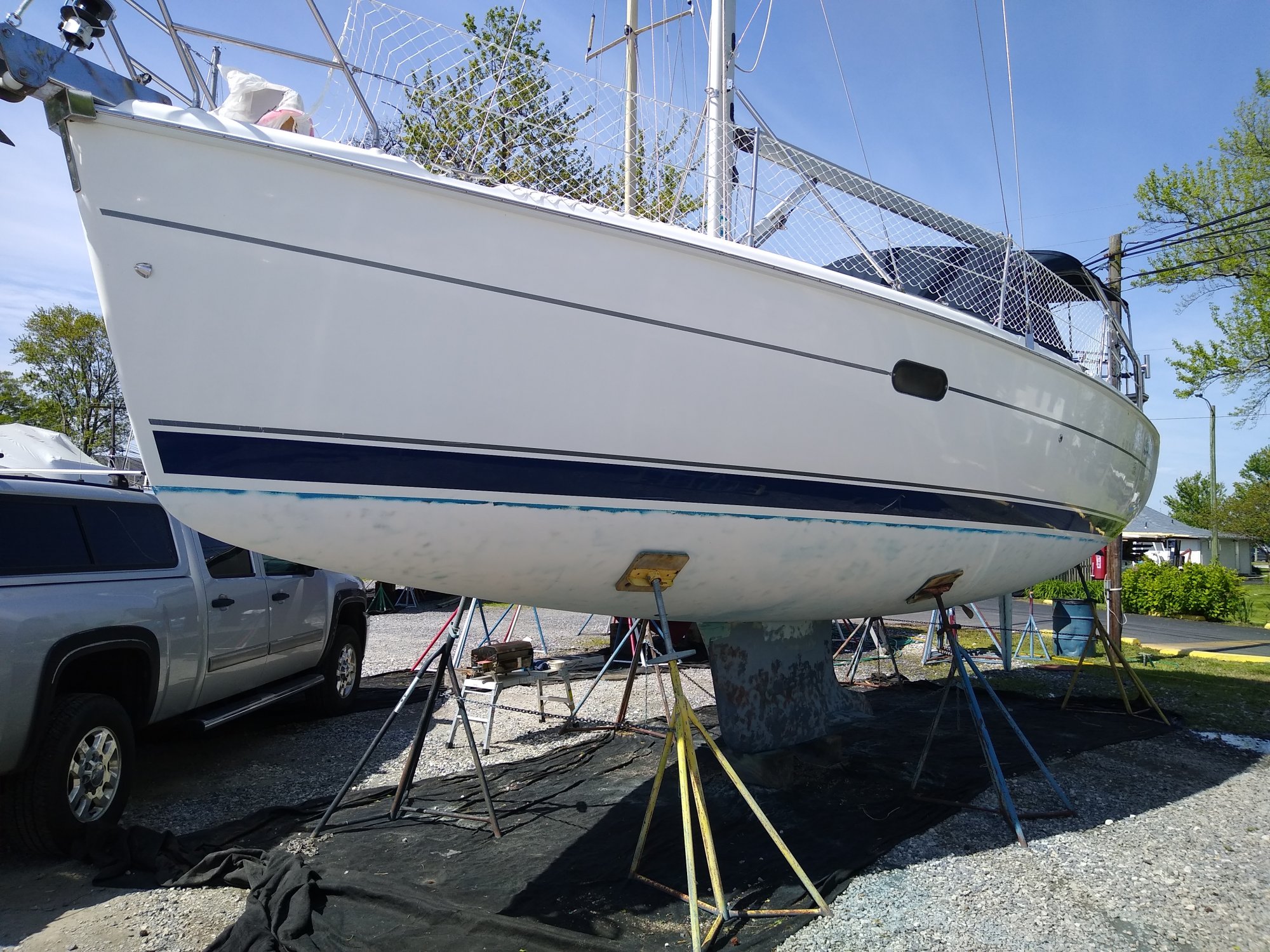

Jeff
Oct 26, 2008
6,358
Catalina 320 Barnegat, NJ
@Ward H So what did the blasting cost for each boat?
dj
p.s. blasting is not supposed to affect the epoxy barrier coat is my understanding.
@Ward H , I'm surprised if you paid $1,850 just for the media blasting. I don't have the receipts in front of me but I think it was $1,400 for mine. Perhaps you had something else built into that price and perhaps I got a little break because I had them do the entire job. @dLj , there is no way in the world that you would ever find me sanding a 41' boat on my own! :biggrin: I could think of very few things that could be more tortuous! I would gladly pay $3K to avoid that job if I thought it was needed. But I will say that you might want to be prepared for the consequence. I don't think Ward had the same issue, but the blasting revealed thousands of tiny blisters just into the gel coat. They were about 3 mm diameter and were everywhere on the hull below the waterline. I think I spent around $2 K to have the hull faired with thickened epoxy before applying the barrier coats. After fairing the hull, I had 3 barrier coats applied before the ablative bottom paint. The result was very satisfying, but expensive. I think that if I had sanded the bottom smooth by getting down just past the built-up paint, I might not have exposed the blisters. It's hard to say. They were just into the gel coat. I didn't have any blisters into the underlying fiberglass. But, it was a little odd to see it. The exposed gel coat was white, the underlying fiberglass at each divot was a reddish color. I learned that the underlying resin has a reddish tint.
