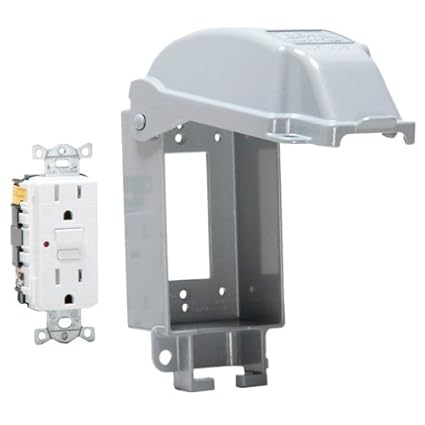

I installed a water resistant 15A 120VAC GFCI outlet in a waterproof box with a cover in the lazerette.
I then mounted my IOTA DLS-30/IQ4 (http://www.iotaengineering.com/dls30.htm) battery charger in the lazerette, and plugged it into the waterproof box. I ran the output of the battery charger to the "1" lead of the 1-BOTH-2-OFF switch. I use Bank 1 as the "House" bank. Bank 2 is maintained with a Xantrex Echo Charger.
