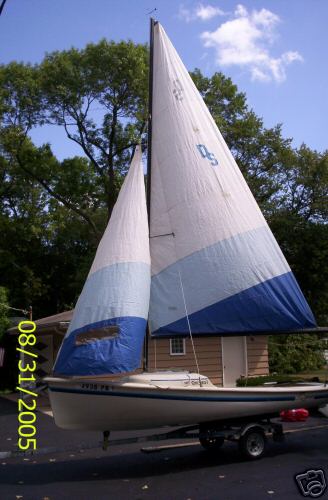

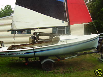

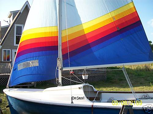

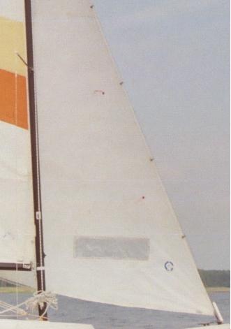

I'll include a few pics of a Spindrift DS I for help. The boat with the red jib must have a replacement jib, since that one looks too small. I also posted a pic of my boat's jib to show the hanks (clips).

Thank you for the reply. I have begun to believe this is correct; the jib was just sold with the boat. It seems to fit and I've had snaps put in now and will purchase some hanks. And thanks for the great images.

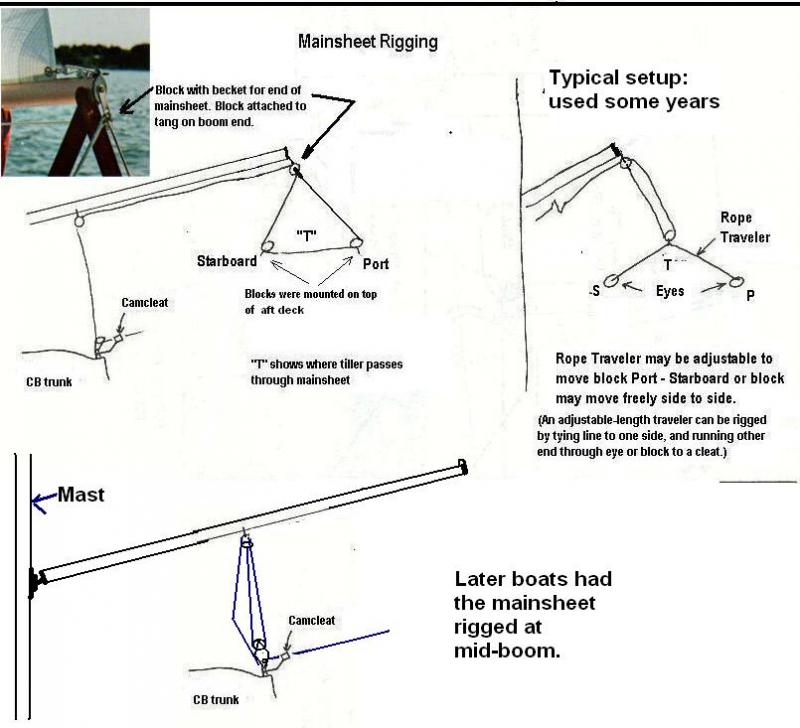

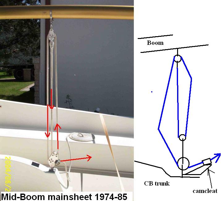

I'm not sure if the Spindrift DS I Manual that I have (in PDF form) is the same that you already have, but I'll attach it anyway. It seems that Spindrift used 2 different ways to rig the mainsheet (different years?) so, I will attach a couple of pictures on that. The pic of the mid-boom mainsheet is actually an O'DAY DS II ,but the general idea should be similar.

Thank you for making the boom (main sheet rigging so clear). I was confused thinking the outhaul had to be tensioned and held for quick release. I do not have the end boom block for a traveler arrangement. Would that be a more desireable rig?
