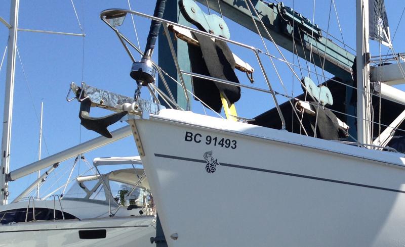

Conventional wisdom is to go as heavy as possible however with the amount of chain you have plus anchor weight I'd be getting concerned about so much weight in the bow.
Not sure how your 386 compares but Our 38 came with the mariner package that had a 25 pound Delta and 20 feet of chain. When I looked at the specs that seemed to be at the margins of the specs for that anchor. Especially with the amount of freeboard the boat has and the way it tends to sail like a banshee on anchor. I upped to 35 feet of chain with the 35 pound Delta. Performs very well.
With as much chain as you have I'd be tempted to look at the specs for the anchor go with a weight that isn't at the low end for the anchor but not at the high end either. And then add a second anchor of a different type for those times when you might need two, or your primary isn't the right kind.
But again bow weight would be a real concern. Our 38 has the 75 gallon water tank in the bow under the Vberth so that's another 600 or so pounds up there.
