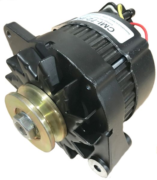

For future reference the CMI-72-IR (also available in an externally regulated version CMI-72-ER) was designed specifically as a replacement 72A alternator for Catalina's or other boats where the OEM Motorola 51A (now discontinued) or 55A (only Chinese clones now available other than some left over NOS units) was originally fit. The 72A stator/rotor combo was chosen to work in concert with the factory 3/8" belt and maximize amperage output while minimizing belt dust. The internal voltage regulator can be pre-set (not field adjustable) during bench testing to your desired value. It is also very reasonably priced.
CMI-72-IR
