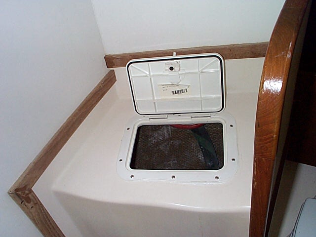

Here is the new raido installation..Still needs the TNC to be installed for Email and WX Fax..Wendy is programing some freqs in..
E
Ed Schenck
Radio and hatch.
Ed, how about some radio details? SSB or ham, make and model, ground plane, antenna type, tuner info, etc. Now that you have that big opening in the shower seat you could put a holding tank in there. :) Glad you posted that picture. I was about to cut the hole for a hatch. But I was going to put it in the front of the seat. I think I like yours better.

Ed, doesn't that hatch do a number on your butt?? Johnny, Figure on the cost of the radio and tuner (what, $1500 to $1700 or so?), insulaters (a couple hundred up) for the backstays, cable from radio to tuner ($100 or so), and the cable from the tuner to the backstay($20 or so). That leaves the ground plane, and that's a lot like a lot of other areas, as many ideas as people giving them. I glassed in about 16 sq ft of bronze screen under the cockpit, then talked to a guy in a harbor in Colombia my first try (from a Texas lake).

Yes..., and no.
