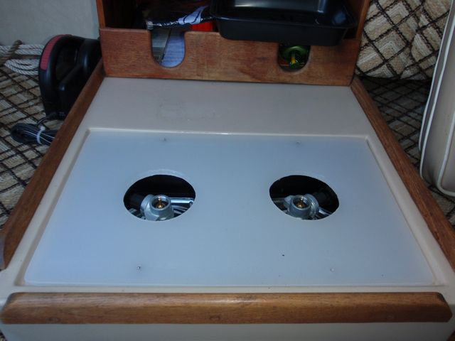

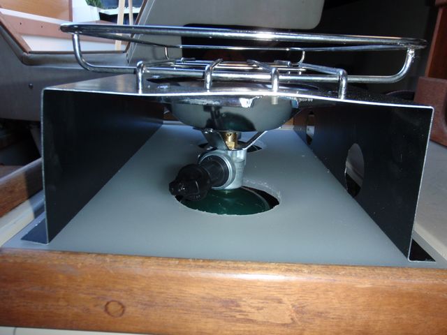

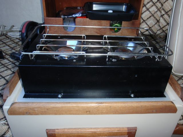

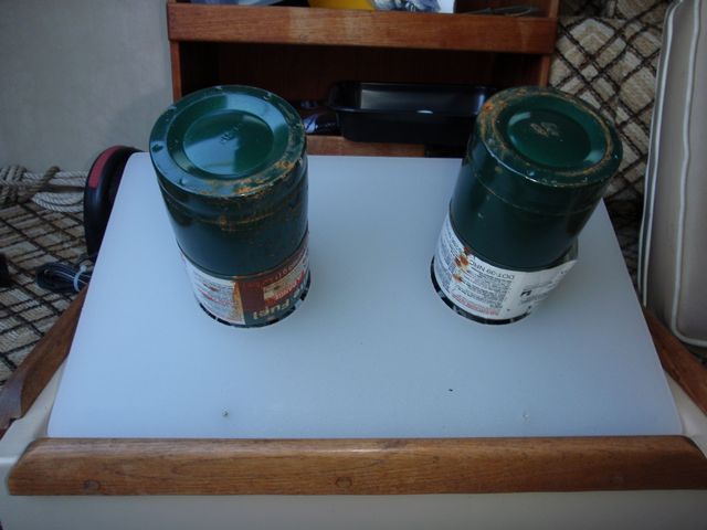

Good evening all. I finished making a 2-burner propane stove to replace the pressurized alcohol stove. I started with two Coleman one burner stoves, cut, bent, and painted some aluminum sheet metal, riveted the burners into place, and mounted the stove to a plastic cutting board. See attached photos. Steve
BTW...does anyone have an idea for a 4" cap to cover the two holes, which wouldn't sit very high off of the stored "cutting board"? SAC
