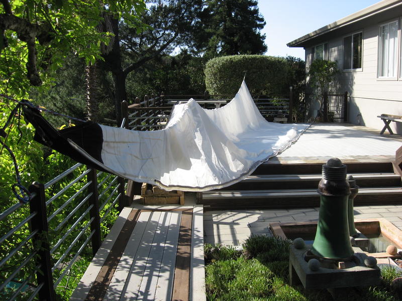

The method I have used to greatly improve the appearance of a dirty/stained sail goes something like this:
- Do early in the morning or in the evening so the wetted sail doesn't dry out quickly. Gives extra time for the cleaners to work. A clean paved/cement driveway is helpful. Or tightly stretch a strong line between a couple of trees. Lengths need to be in excess of your luff length. A couple of 6-7ft 2x4's will be needed to prop up the line in the middle to compensate for the sag. Drape the sail over the line like in the attached picture.
- The cleaners I use are actually from dollar tree. First thing is wet the sail with H20. Next is to spray-on Dollar Tree's tire/wheel cleaner or their auto degreaser. Both these are really quite strong, so as you do in your contracting business, take adequate protection for eyes and skin. I pore a couple of 32oz bottles into a 1 gal garden sprayer, then fill the rest with water.
- Let sit for a while to work. You can try to blast clean with a garden hose, but more recently I have used a small electric power washer on the fan spray setting. Keep close enough to dislodge the dirt and mildew, but never close enough to damage the fabric or stitching.
- Next I spray on a mild oxalic acid. Again from Dollar Tree. It's a tub and shower cleaner called "the Works". In a white/green squeeze bottle. As above, I apply with the garden sprayer. Oxalic acid will improve the tan/yellow tannin stained color of the sail. Also, but it generally takes several spot applications, rust stains will disappear or be signicantly diminished with oxalic acid.
Of course do both sides. End with an H2O rinse.

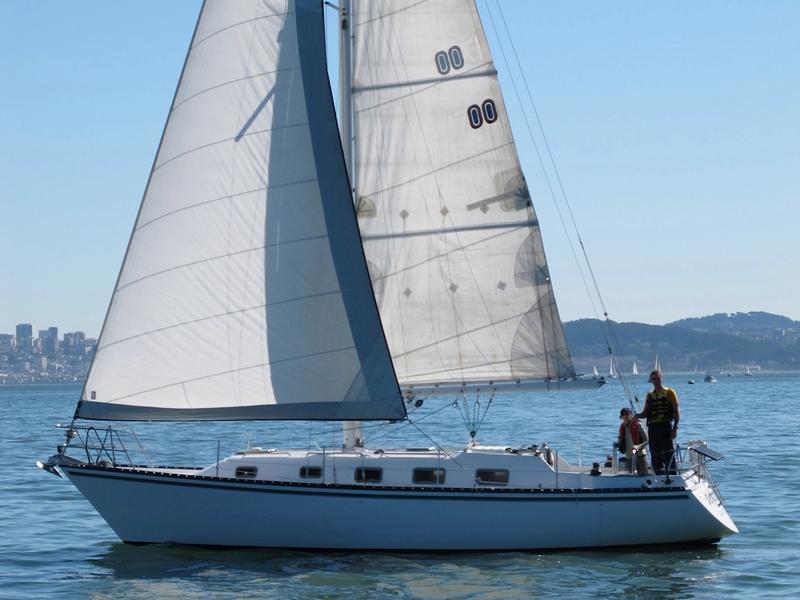

I have never observed any damage from the cleaning to my old Dacron sails. The sailing performance isn't any better, but flying the sail is no longer a visual embarrassment.
The sails in the attached pictures are 1980's old. They were yellow and rust stained prior to cleaning. On close inspection, still not perfectly white and some stains around. But an overall large improvement.
