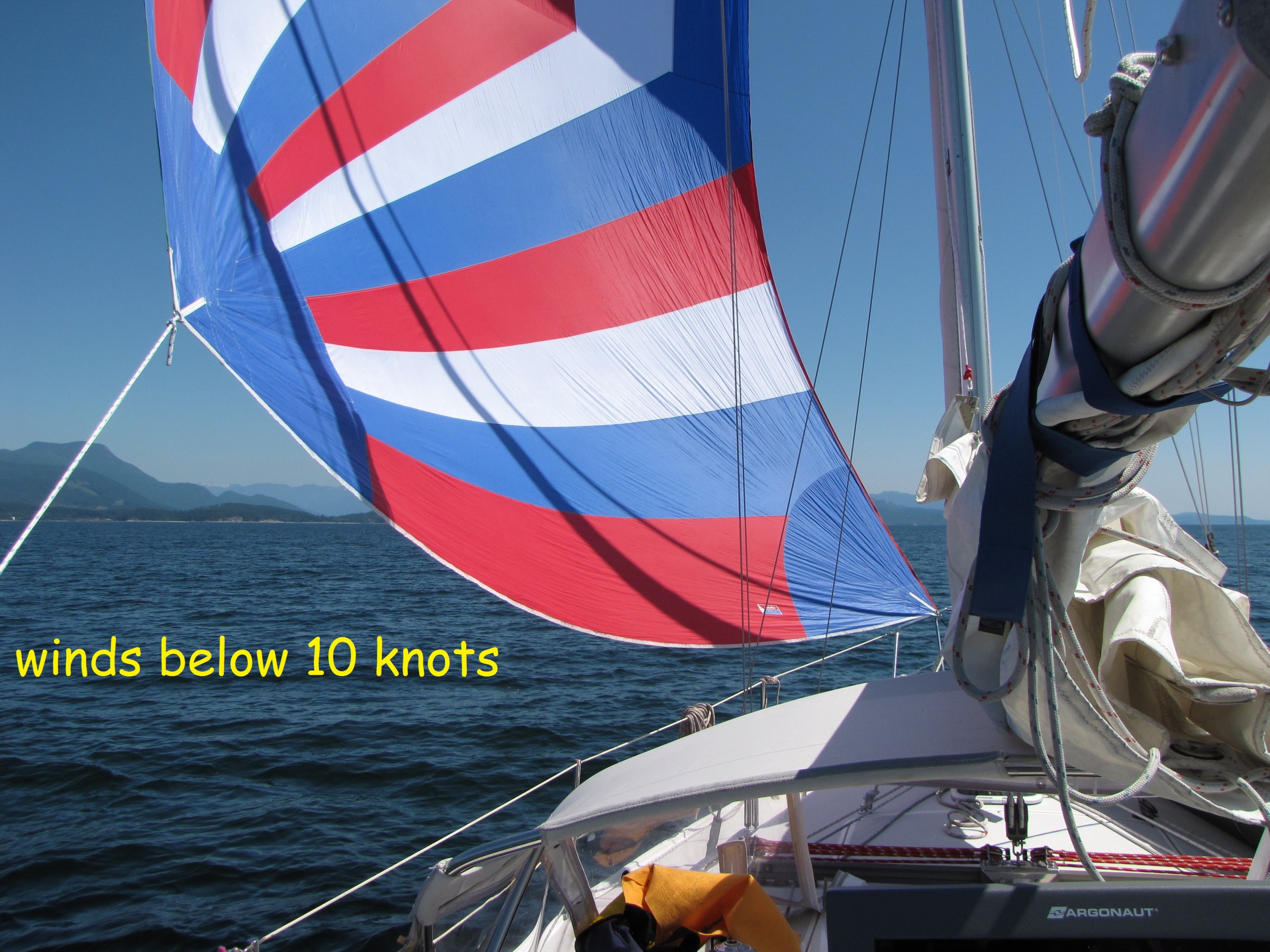

We have ONLY an inside track. Many of our boats came with both. Of course, outside (gunwale) tracks won't let you head up as much, but the only trade off I've seen (besides barberhaulers) is to run dual jib sheets.

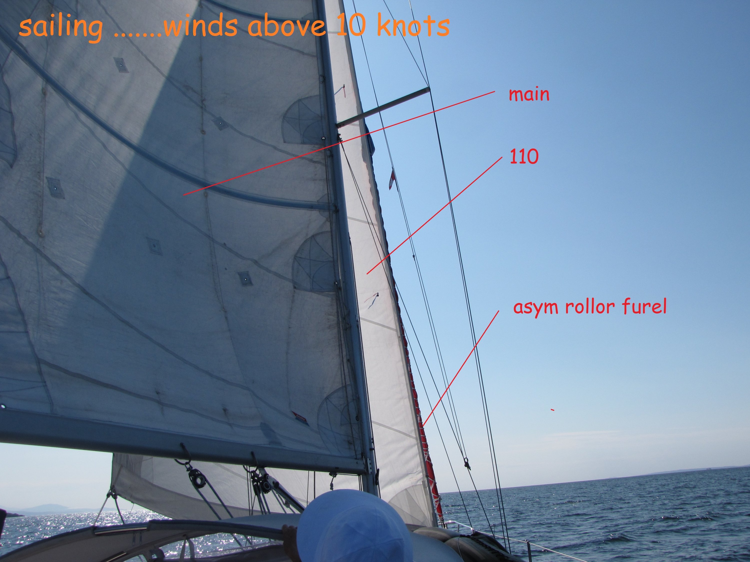

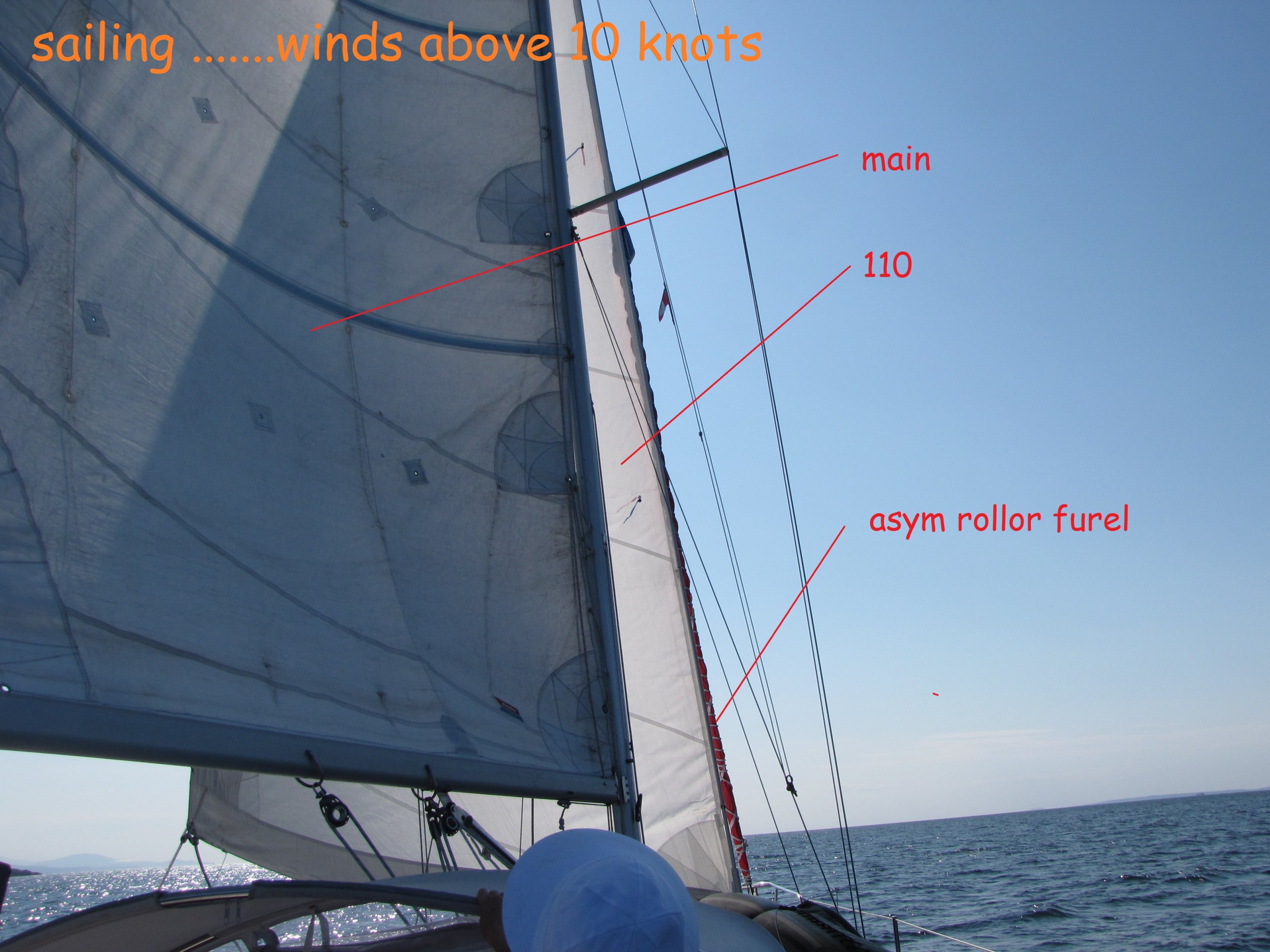

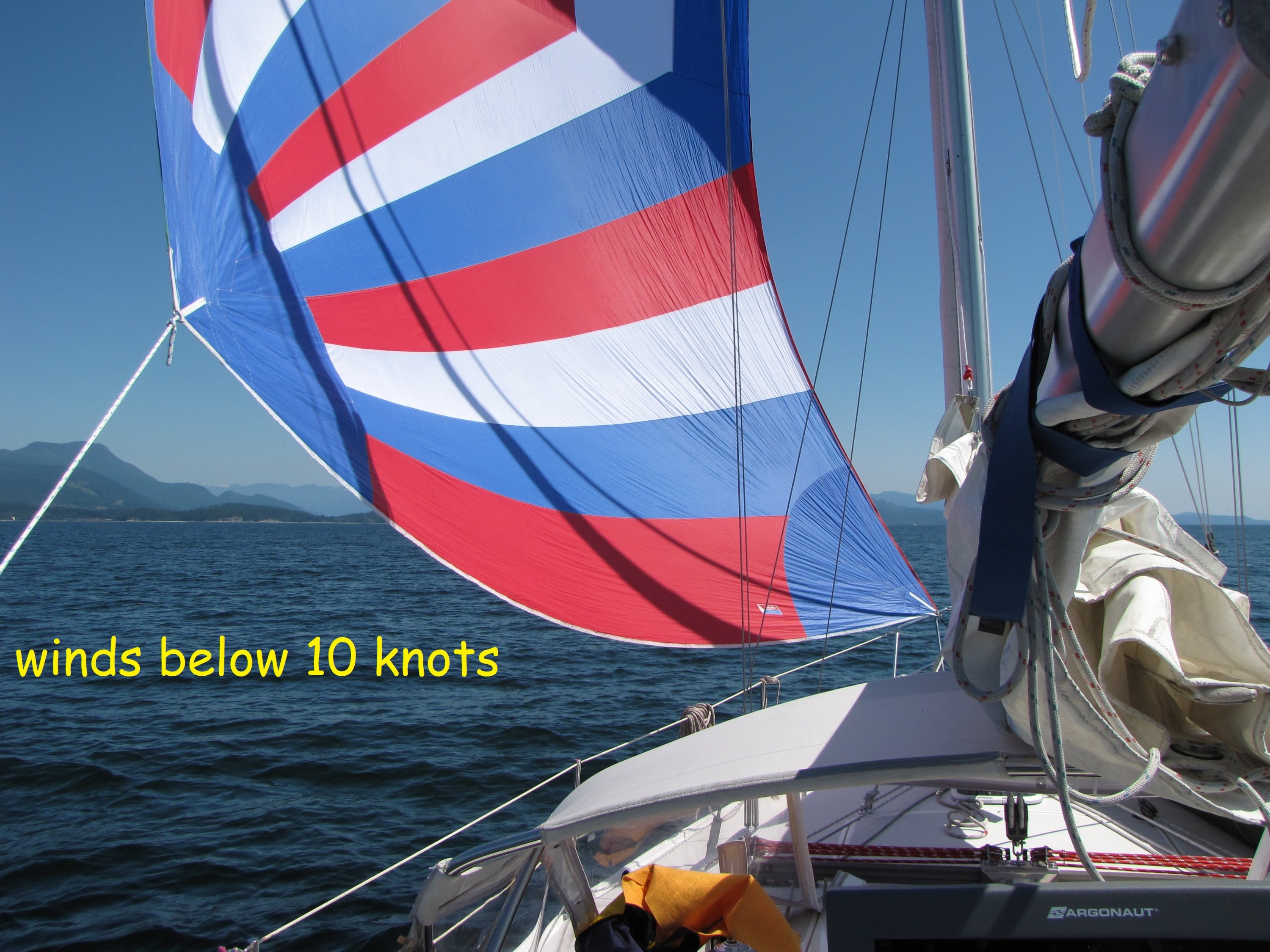

I run an 85% in the high summer winds and a 110 in winter or for summer racing.

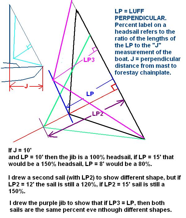

One of another recurring type of questions is "LP" or luff perpendicular. From one of those discussions I saved this image. The point (pi) is that you can have a BIGGER jib while still moving the clew up off the deck. Not all 130s have to be decksweepers. Talk to your sailmaker, because the position of the clew is also important to the position of your track. The higher the clew usually the track's forwardmost position position can be further aft, so if you have what you call a "short" track can work, where it wouldn't with a decksweeper.
Good luck.
