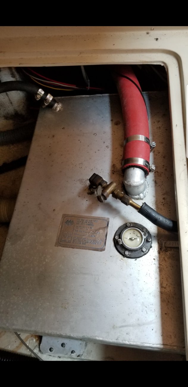

Few more clues..
The fuel supply valve was open. I closed it before removing the line.
I can blow air down the fuel supply line.. so it's not clogged.
The fuel supply fitting has a slow drip with the valve open. 1 drop a sec.
The fuel vent line sprayed gas as soon as I removed the line. Fuel is pouring down the line and up out of the tank.
I have no fuel gague anywhere so I assumed that it was empty at first. But obviously it's overfilled. Turns out the fuel gague is on the tank!
So here's the mystery... if the fuel vent is spraying gasoline... why isn't the fuel line? Looks like the problem is in the tank suply fitting/valve?

You do have a fuel gauge. It is that round thing on top of the tank.
It I can’t read it in the photo.
If the fuel vent line ( the black hose in the corner with 2 hose clamps) sprays fuel, then there is a pressure buildup in the tank and the vent is probably blocked. The vent should allow the tank to “breathe”.
The fuel pickup tube is under the fitting with the shut off valve. I can’t see how that fitting comes off the tank, but you need to remove it, and the pickup tube should be connected and runs down into the tank. Check for a screen at the bottom of the tube, or check the inside of the tube for blockage.
Yup I mentioned I found it on the tank above
The pressure in the tank and the line could also be from excess fuel in the lines above the tank?
A good test would be to try and blow air out the vent line. That would indicate if it's blocked.. I wanted to try that but the fuel just gushes out in to the bilge. Nees to get that under control..
Sounds like a good plan. Trying to be careful not to damage the aluminum..

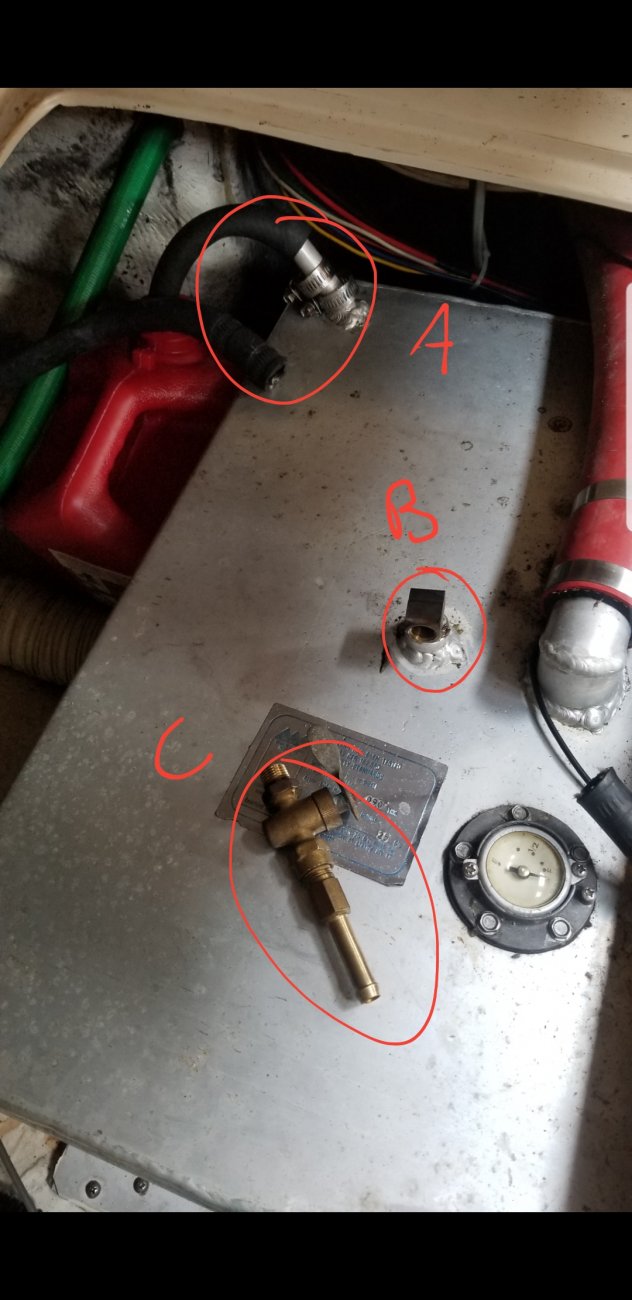

Good ideas. I did more testing...
New clues..
I can blow out the vent hose. No blockage. (A)
I can blow air in to the gas tank through the supply port on the tank (B). No blockage there..
But I can hardly blow any air through the shut off valve (C).. in any position... or direction. strange.. headed to west marine to get mugged.

Take off the valve open it and see if you can see through it or run a piece of wire through it. You may not need a new valve if it’s just a piece of crud in it. Be extremely careful with “gasoline in the bilge” with the leaks you experienced you now have an explosion potential! Gas fumes are heavier than air and accumulate in the low point. Do not create and sparks, don’t use the stove or turn on switches until you empty the bilge and use a blower to remove any fumes! I saw a boat blow up once in a lake and burn to the waterline, crew in the water needing rescue. If you don’t understand this or are uncomfortable get professional help!
