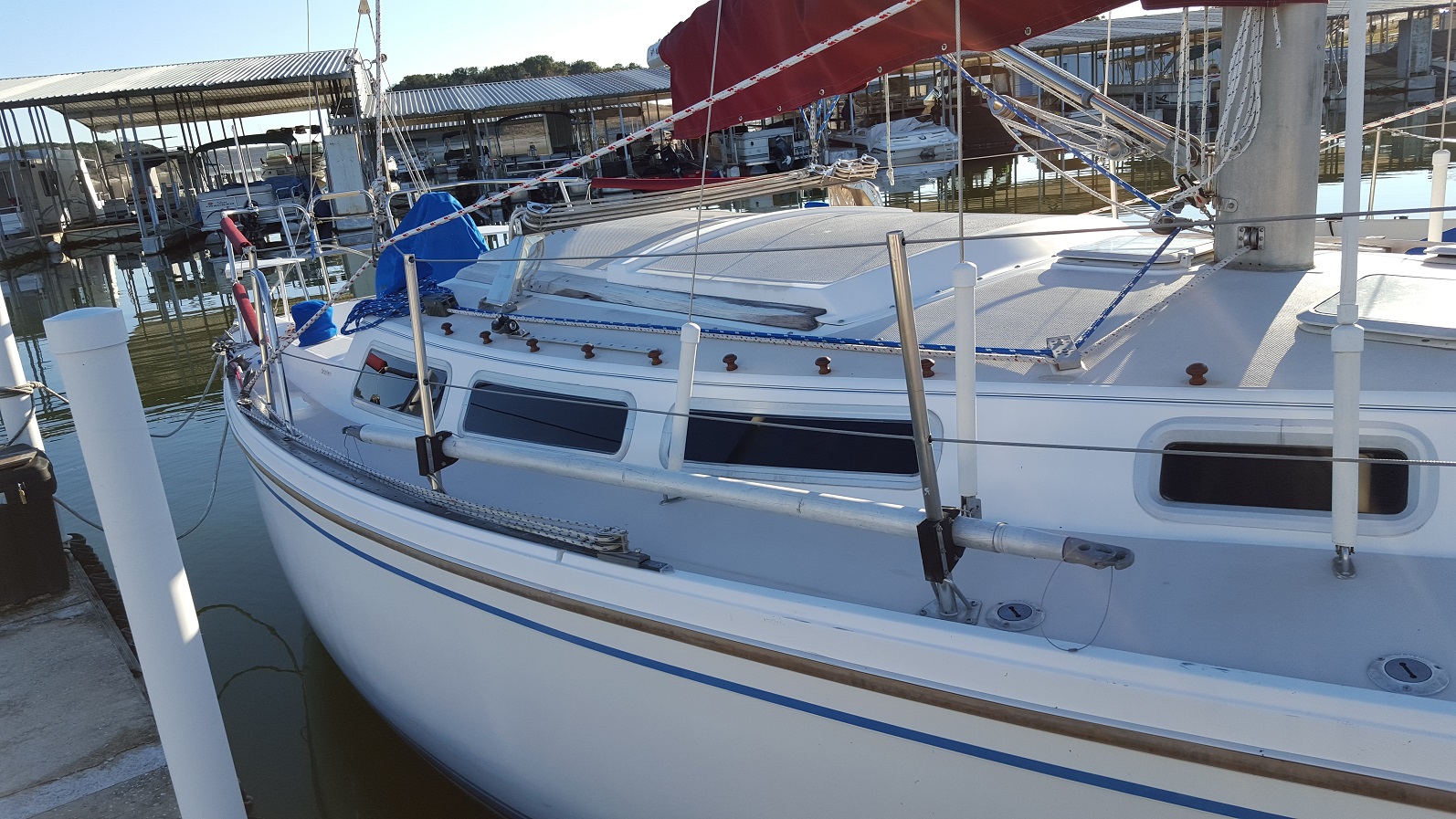

Needed to Replace Teak Handrails
23,130
Very interesting, John. What are they and where did you get them? Cetol or varnish? :banghead::banghead::yikes::yikes::dancing: Just kiddin'...:)
Jul 14, 2015
840
Catalina 30 Stillhouse Hollow Marina
Cabinet door knobs. Great for hanging lines on. I watched myself for several sails and found I never used the handrails while going forward, I used the lifelines and stays 100% of the time. Only used the old worn handrails for hanging my lines on after use.

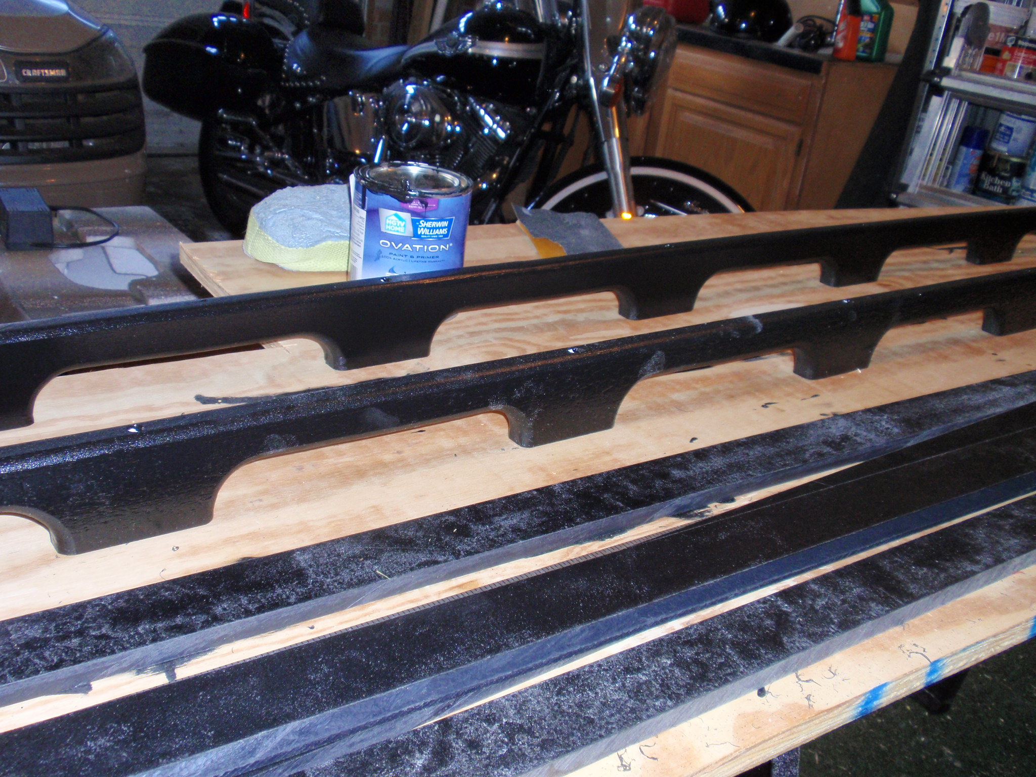

Very frugal! Maybe not as much as my $20 Lowes pvc board handrails :) .I too always use the lifelines and shrouds. I'm too tall to bend over to grab those handrails anyway.

Great idea, but I will take the labor involved in my solution........

My 35 year old teak is toast. Decided to replace with black pvc and Starboard. Crib boards will be white Starboard with black frame. It may give the old Cherubini a modern feel. Still keeping the interior teak.....that I could save anyway.

I was watching the following video the other day and kept thinking about some of the grab rail alternative modifications that some people have installed. While grab rails aren't always used while transiting fore to aft in moderate conditions, there may be times when you wish you had something stronger and easier to grab onto. Although cabinet door knobs may be great for hanging lines, they would be almost useless for keeping you on the boat, especially if you're being dragged through the water. It does happen, and most of the time it's when you least expect it. People have also used synthetic products like plastic or composite wood products to make handrails. They look good and are maintenance free, but some of those products can fail/break when loaded like you would expect in near man overboard situation. Just saying. Select your materials carefully and stay safe. Even wire lifelines are difficult to hold onto because they are so thin but at least they won't break. Check out the 3:20 minute mark and you'll see what I mean.

john you have some kind of pole being held to your stanchions with some kind of brackets, which seems might be perfect for my boat hook. what are the brackets and where did you get them?
Jul 14, 2015
840
They were on the boat when I bought. They hold the spinnaker pole. I will take a close up picture for you tomorrow
