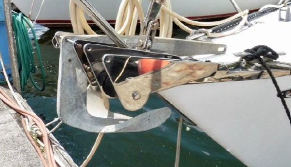

..........only issue then is opening the anchor locker as it swings open from the starboard side with its hinges on the port side and the rode would be blocking it. Also one other issue I am trying to tackle is that the current bow roller is one solid welded piece attached to the furling jib and I would need to somehow remove that to get a new bow roller for the 45lb Rocna vulcan and 5/16" chain I just purchased........
A photo of your anchor door interference would help. This 1981 Catalina 38 1981 Catalina 38 Sloop for sale - YachtWorld appears to have replaces his bow roller as shown.

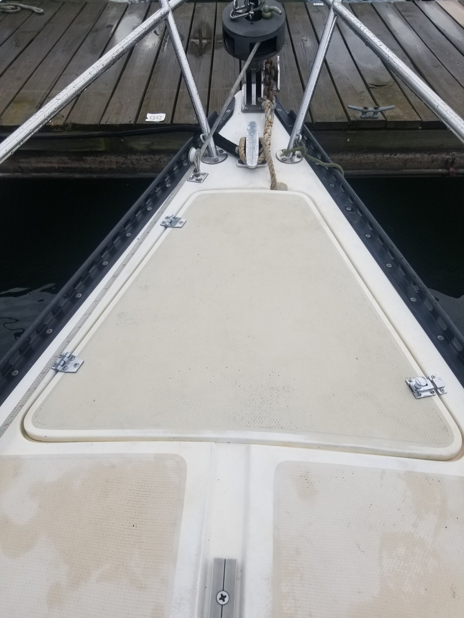

Jul 25, 2021
5
Catalina 38 McKinley
Attached are some photo's of my configuration.
The deepest part of the anchor locker is 22" which is directly under the door.
The deck lip extending forward from the aft end of the locker is 10" in length
The depth from the underside of the deck at the aft side of the locker is 9" and at the fore end of that lip is 13"
The distance from the bow of the boat to the start of the anchor locker door is 23"
Ideally I'd like to have the windlass sit inside the locker to keep the deck clean, however if it's going to be much easier to install on the top of the deck near the aft of the anchor locker then I'm okay with it. I've been looking at other catalina configs and see that some 36's have the windlass sitting on some sort of plate inside the locker, but I'm really not coming up with much for the 38's.
Also I believe I need a new bow roller to fit a 5/16" chain and would likely need one that extends out past my bow to accommodate the 44lb vulcan anchor I purchased. Would sawing off the original one and bolting in a new one next to it be logical? I am fairly handy with tools and there isnt many jobs that I dont think I can handle, I just have no experience with doing something like this on a sailboat and want to make sure I'm doing the right thing before I start cutting anything or drilling into the deck. Thanks!
