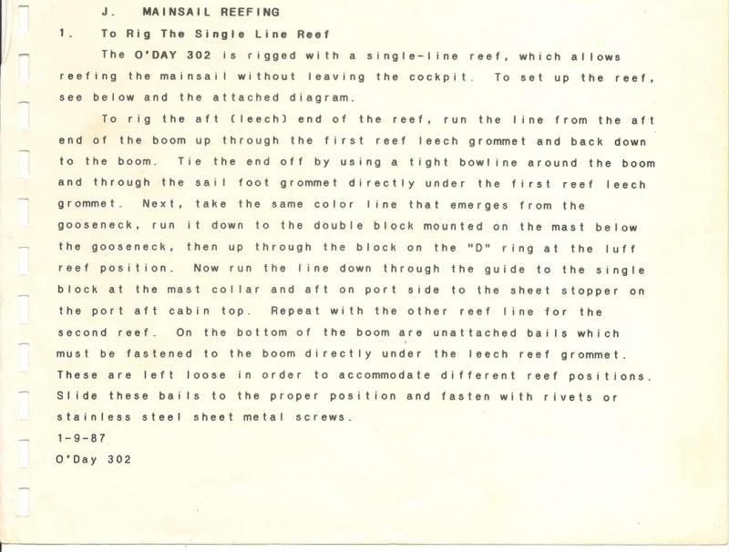

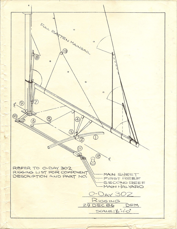

Don't suppose you have any pictures of your 2-reef line setup? Was trying to figure this out yesterday... My seller left me with both reef lines coiled nice,y in cockpit and ran through clutches through double blocks, up the mast, into the boom and they both surface at aft end of boom with stopper knots. It appears I'd need to take each respective reef line and run up and through their respective cringle point in the sail. But where it gets confusing (assuming this first step is correct) is how does this reef line bring down the forward section of the sail? I see a cringle on the forward sail section that looks like its for the reefing line but not sure how reefing line gets to that from where it's at in the aft end of the boom. My one thought was that they put the line in wrong and that it should first run up mast to forward cringle, back down and through the inside of the boom and then up to aft cringle where it's tied off thereby allowing the reef line to pull down forward and aft reef points together nicely.
