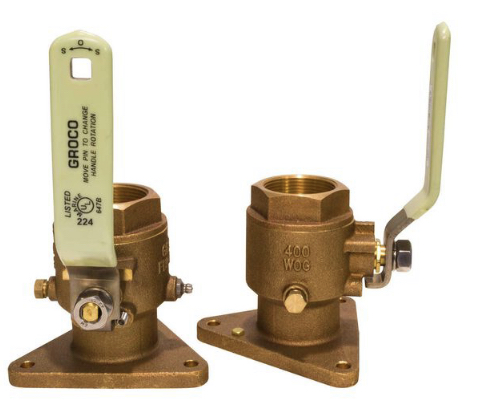

Need to replace sea cocks on my Hunter 45cc. What is the consensus regarding replacing with bronze or plastic. Original are bronze
Dec 25, 2000
6,071
Our original 1991 bronze seacocks still work with occasional lubrication. Why do you need to replace yours? Likely stay with bronze if they ever need replacing.
Apr 5, 2009
3,334
I recently installed Marelon series 93 seacocks and am very happy with them and really appreciate that they are self-lubricating do not suffer from galvanic corrosion.
