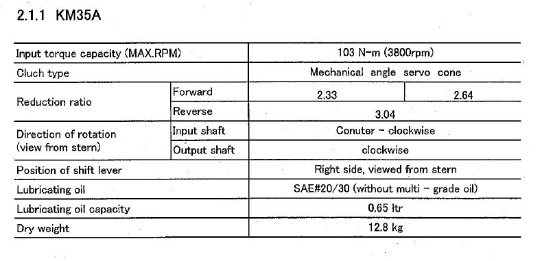

I believe this should be your transmission, note the differential between the forward and reverse ratio's
approximately 23% or 13% differential between forward and reverse, you reported a 21% differential between the RPM's which leads me to believe it is likely you have a ratio of 2.33:1 in forward.

The issue with being over propped is you are loading the engines torque output in the wrong part of the power curve. I believe your motor reaches maximum output at 3800 RPM, the prop you have on right now is demanding max torque at 2700 RPM's the motor is really not designed to provide the HP at this RPM, I would say that you can't get any further RPM as you are maxed out for HP at 2700 RPM if all that makes sense.

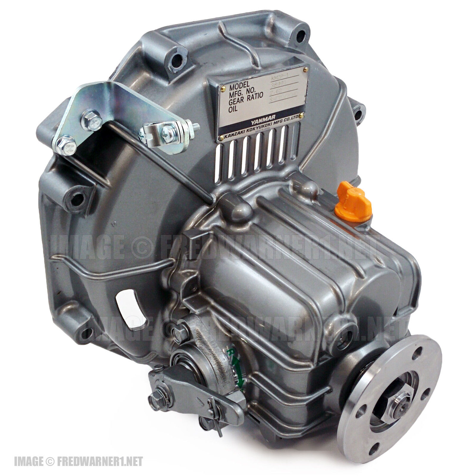

Checked the transmission. It's a Kanzaki KM2P-1, forward ratio, 2.62, reverse, 3.06. The good news is I got the boat out yesterday for several hours, thoroughly warmed up everything, and saw over 3K RPM in forward. I've not calibrated the tach in a while, but I think that's pretty accurate. At about 3100, it pushed the boat at 6 knots into a 12 knot headwind, so no complaints there. I do think the old cable was holding me back previously, and then I was seeing the low max speed at the dock, which isn't the best measurement. Boy, am I relieved that I don't have to ask Flex-o-Fold to do something about a prop I bought more than two years ago, but only installed this season. Don't know why I posted the stock transmission photo. I guess I just think it's pretty!
