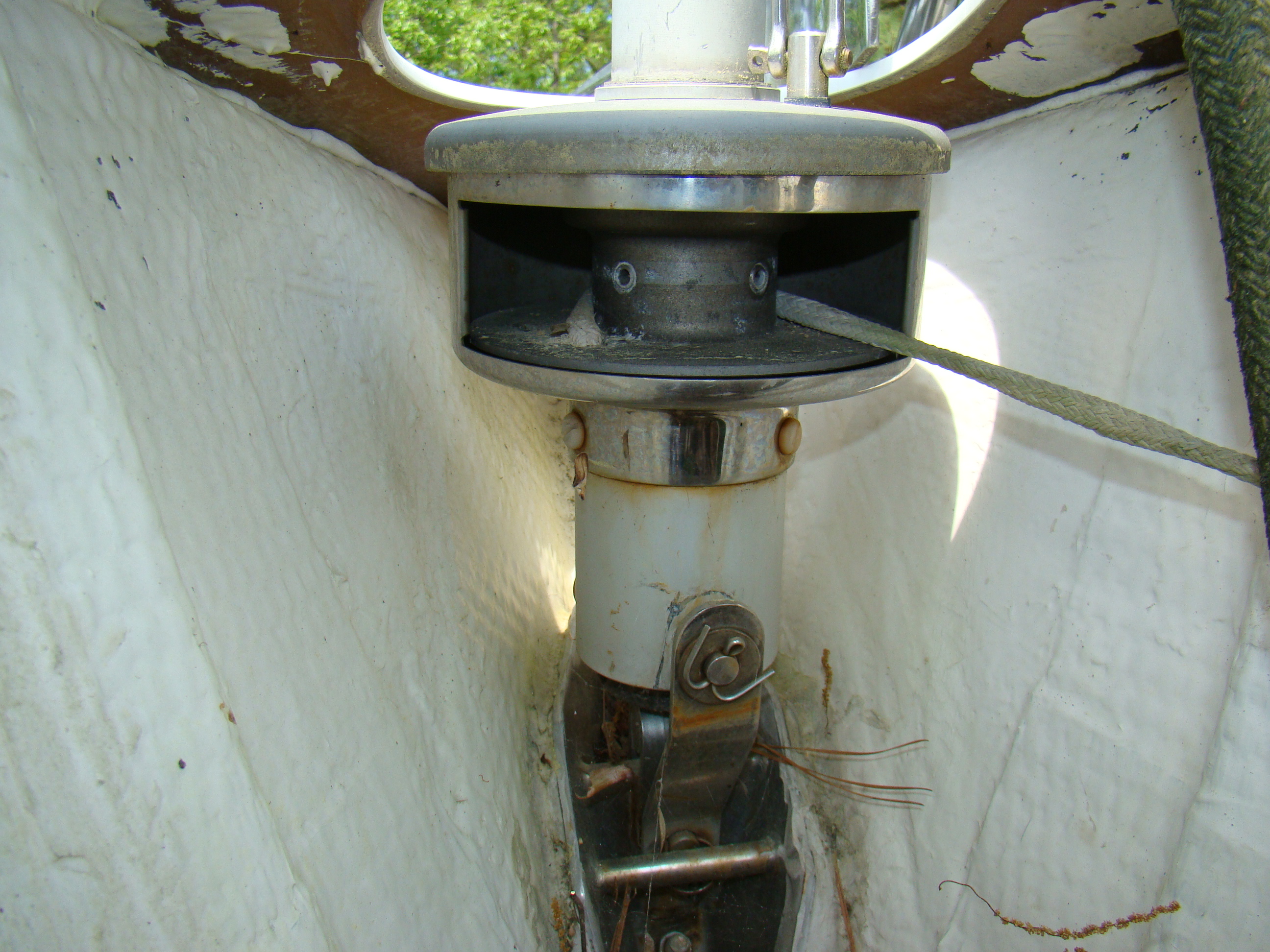

I tried to open the drum on my Hood furler to change the line, but the stainless steel cover is seized to the aluminum post. I soaked it in PB Blaster for two weeks, applied heat, tried pounding and twisting with wrenches, but nothing was going to get them apart. Finally, I tried to pry the cover down be inserting a screwdriver between the shroud and the spool. The bottom of the spool snapped off and now I need to find a source for parts.
I'm not sure of the model number, but it is the same as the photo from another member's post. Does anybody know what the model number is for this furler and if spare or used parts are available?

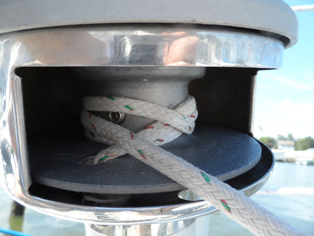

For the record, there is NO NEED to take anything apart to change the line. Simply tie a small stopper on the end of the line, and then secure the line to the drum with a clove hitch. The set screws will grab the clove hitch, and the stopper is just for insurance. I wish you'd have read my blog post on Hood furlers; it would have saved a lot of work and money. My book, "Keeping a Cruising Boat for Peanuts" is full of tips like this. The link to the bookstore is in my signature.
http://sail-delmarva.blogspot.com/2009/09/hood-seafurl-800-bearing-replacement.html
In this picture I stuffed the overhand knot though the hole with a screw driver, just for neatness, but it wouldn't hold much. The clove hitch does the holding. Very easy.
