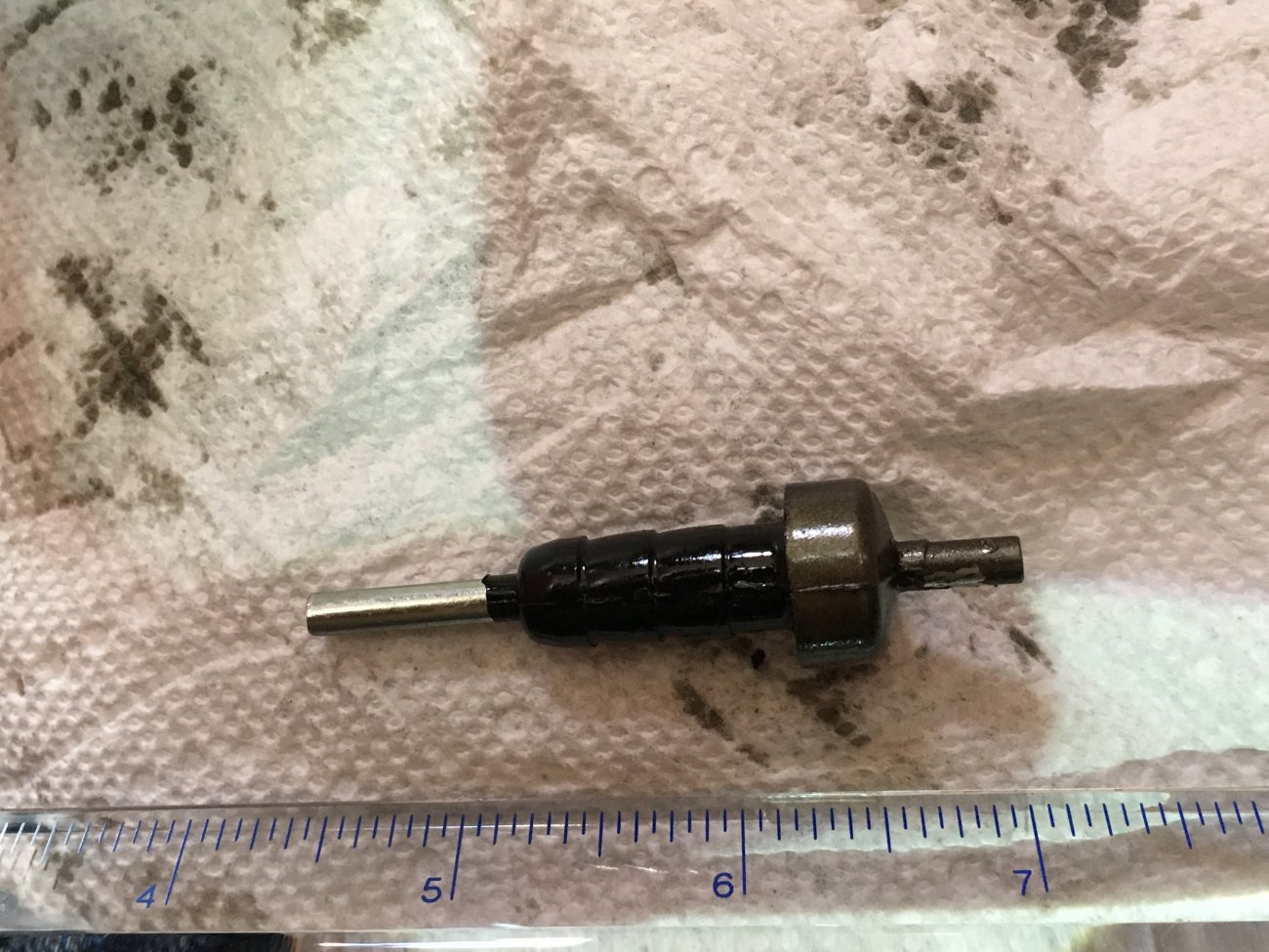

Morning check on cruise revealed a sump full of oil. I think I tracked the problem down to a failed oil filter gasket. Then I found this plug-like part in the sump. (Photo attached) What is it, and where does it get replaced?

It does look like the top of the dip stick, but the dip stick is intact and functional.

Almost looks like a push rod for something? Maybe the blender? My 3YM book is on the boat, so I'll look on Sunday EST.

Wow!
That is a puzzle.
It does look like the top end of a dip stick.
https://j109.org/docs/yanmar_3ym30_parts_catalog.pdf page 15
BUT,if so both ends have been cut off cleanly ( why would anyone do that?)
The diameter of the end cap is way larger than the dip stick tube, so how do it get into the sump?
There is no way it could have been dropped in.
If it has been in the sump for any length on time it would have rolled and tumbled about and end up at least polished. It isn't,
Beyond me and I am hanging out for an answer to this one.

Have never seen anything like it on my 3YM30. The internal side of the oil dipstick is flat and the one appearing in the photo is round. The dipstick for the transmission doesn't look anything like the photo. BUT it definitely looks like some sort of dipstick. Mystery to me!

diag 20 for full inj pump, # 42? a tappet stopper?
Thanks for looking that up! The injectors are intact on my engine, and the part’s pins at either end don’t match the tapper stopper drawing.

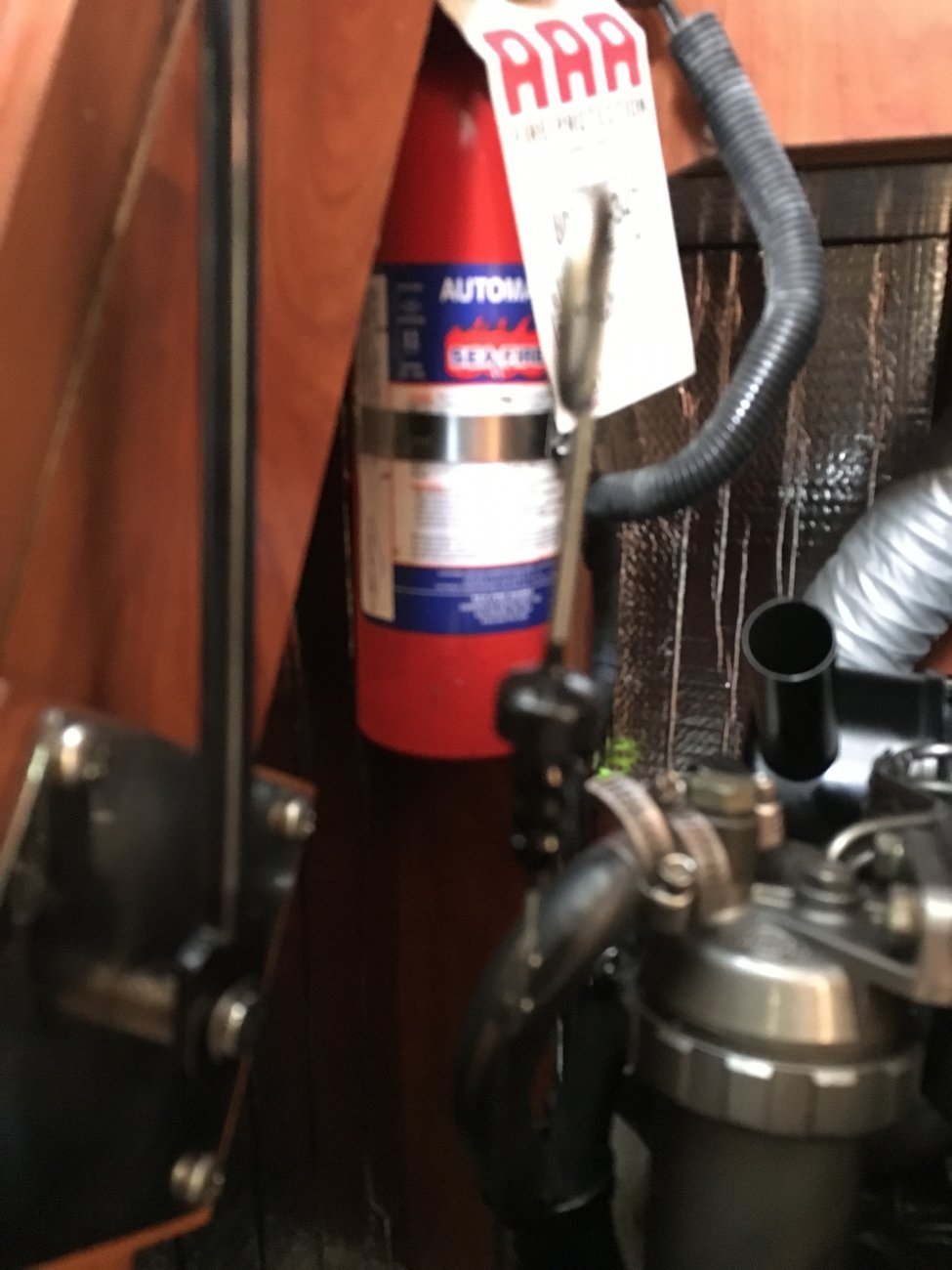

A buddy from Hunter Association of Puget Sound found the part. Page 15 part #7, “cap”. It seems that Yamar provided for a starboard dip stick as an option, and just capped the hole. Read this entry on cruiser’s forum which describes the issue and has photos of the part in question along with placement.

Will definitely check this out. Seems that Yanmar would have had a better solution for sealing the alternate oil plug port. Perhaps it would be a good idea to place some type of sealer on the plug to prevent it from coming out again.
I used a piece of Rescue Tape around the rubber plug to securely seat the part. Six weeks later, it is still securely seated.

I wonder why, when the plug was removed, you lost oil through the opening. Is there a tub coming up, like the dip stick side, or just a hole in the oil sump?

I just ordered some permatex aviation gasket sealer. I plan to clean the plug thoroughly and seal it to the port in the engine block. I don’t want this thing coming out at an inopportune time, or forever.
