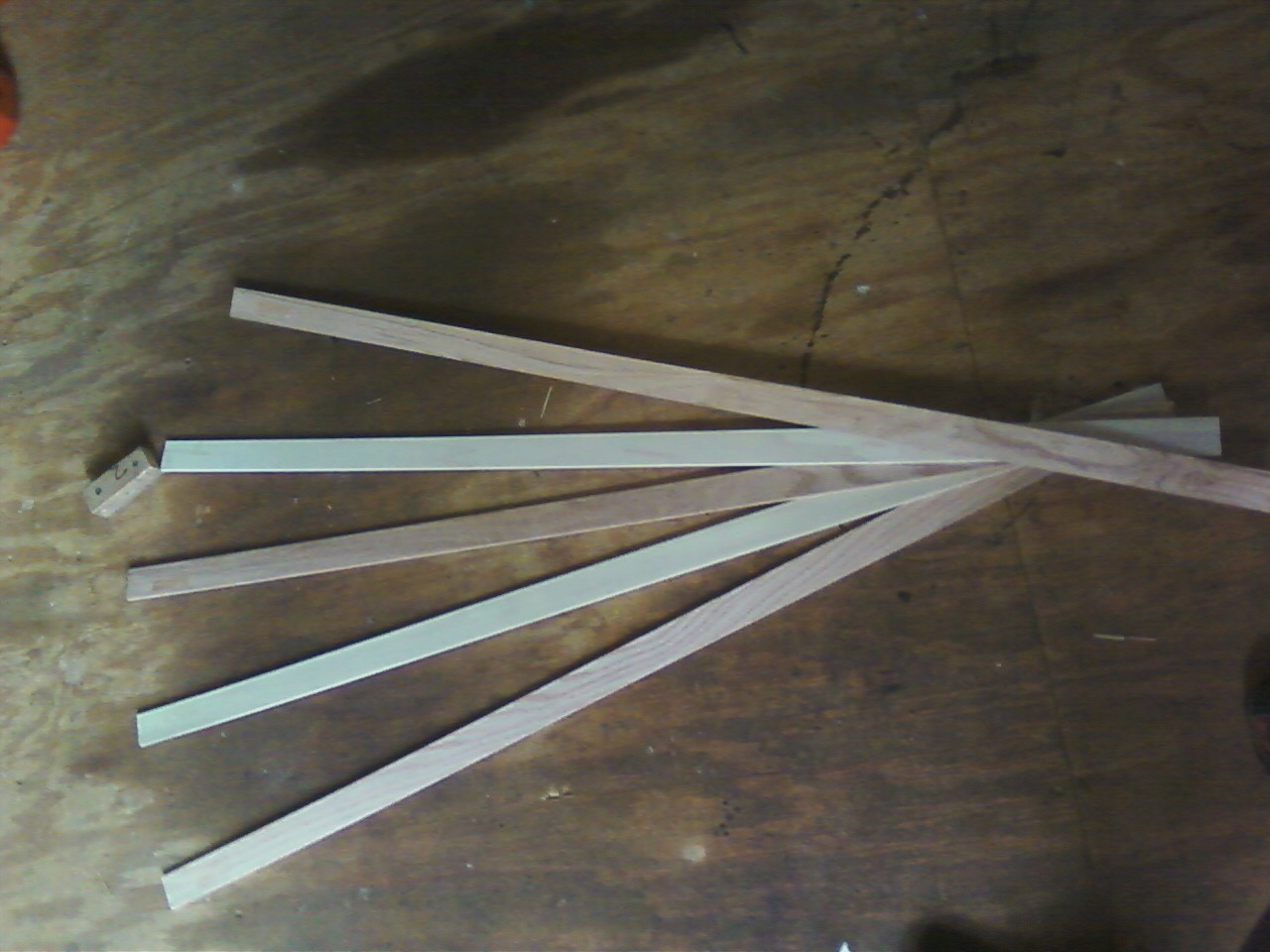

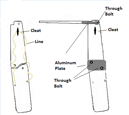

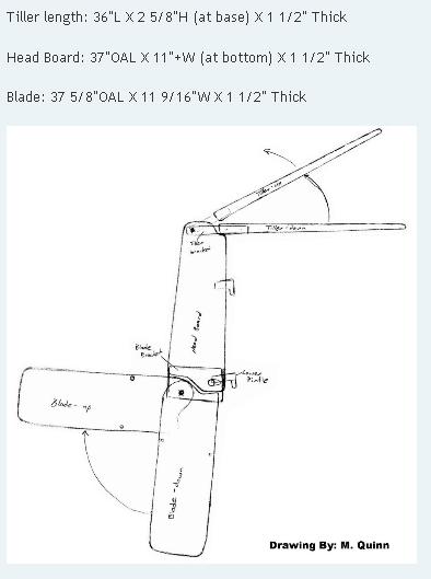

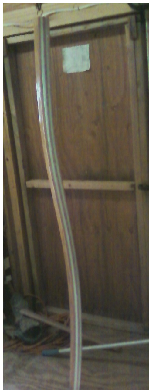

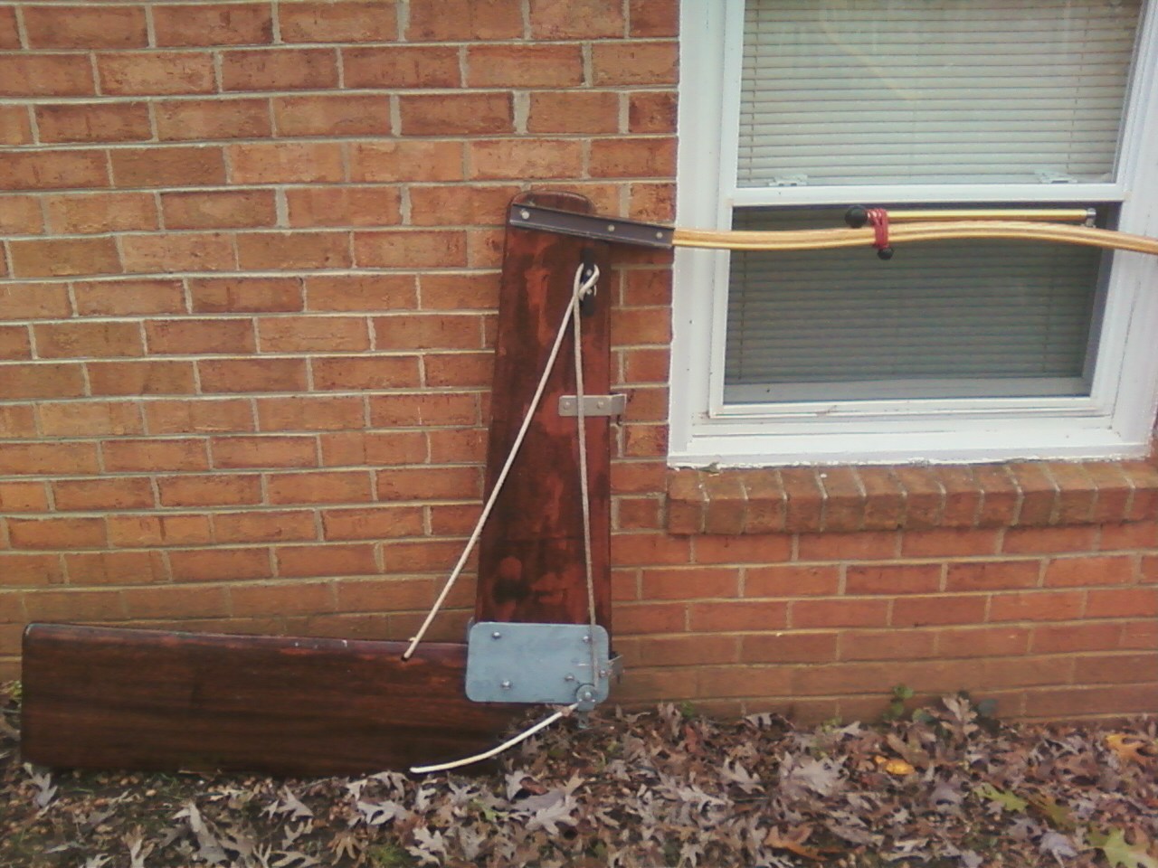

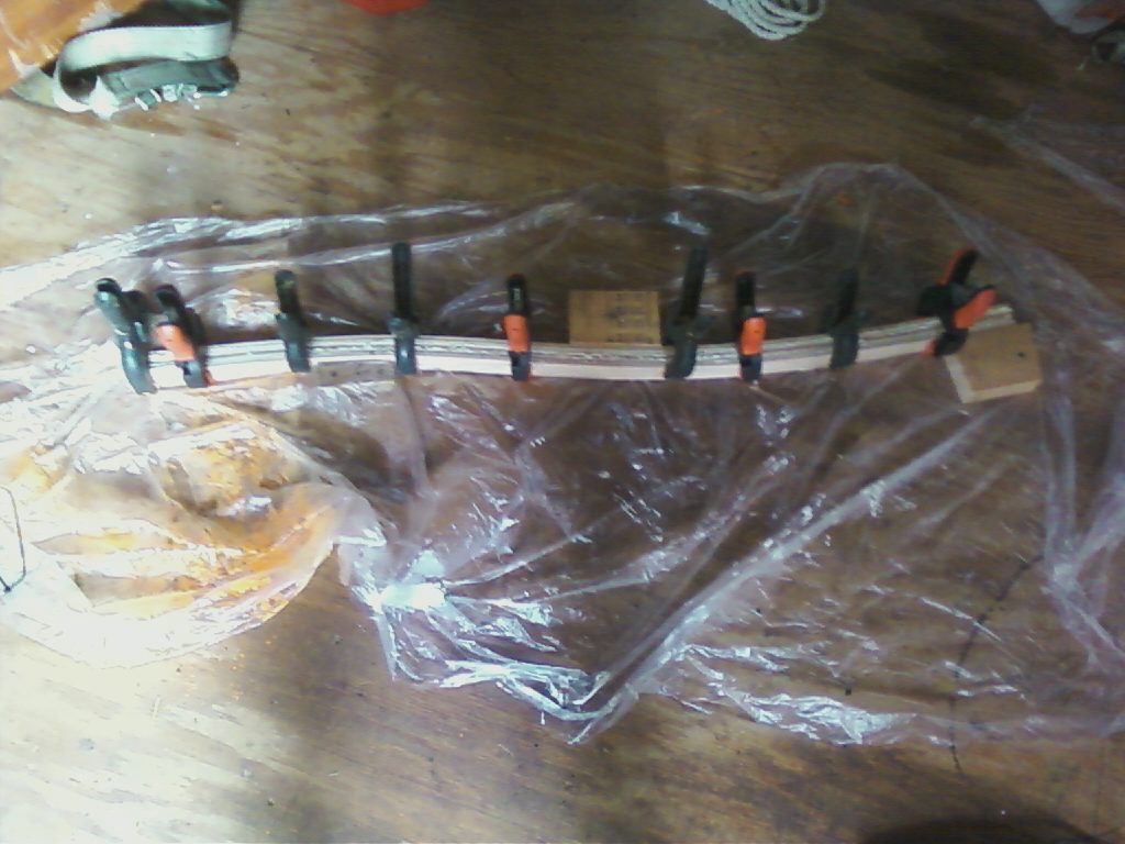

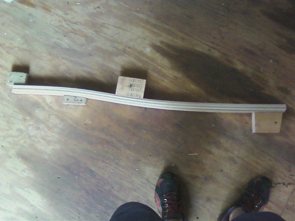

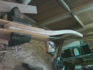

I had to make a rudder once. I had lost one for a Macgrefor V22. Here are pics of the basic idea, you would want to adjust dimensions to fit your boat... I also included some pics of the tiller I made and the process for that. The last pic is the final product. I made the actual rudder blade from a piece of 2"x12" board I had left over from a deck joist. I then used an electric planner to give it a foil-like shape. That was done "by eye" and was the most time consuming part of the project. You have to take it slow.
