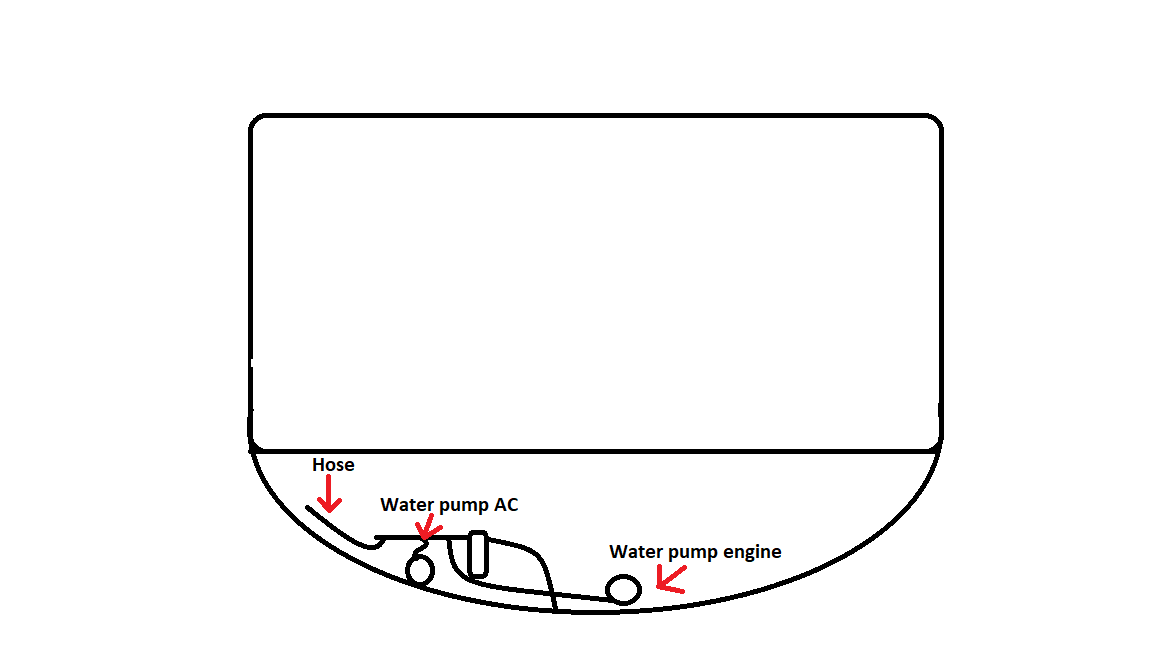

I don't know why it loses prime. The setup is a bit odd. I have a thru hole cock that comes into a strainer, from the strainer there is a three with three exit valves. One goes to engine water pump, one goes to AC pump, and one goes to a hose that may be used to wash down the bilge or something... I don't know what this third one is. When I lose prime I check the strainer, nothing. I open the third valve and water flows into my bilge. I turn on pump, and it is now primed and working. ...well, now it's dead. :) I put my old one in, but it works outside the boat (spins), but not under load.

My boat has 3 a/c units attached to one pump, but the a/c water feed is from a separate, dedicated sea cock. A 3/4" hose runs from the sea cock to a strainer to the pump. I think you are losing prime because of the multiple connections for the a/c raw water supply.
I have an extra sea cock near the current feed, nothing is hooked up to it; actually, I was going to install a brass 3/4 plug in it this weekend as I am not using it and don't want it opened by mistake or have it fail.
If I wanted to use the alternate seacock, I'd have to install a new strainer too I assume to keep crap out of the AC units.
However, the seacock that feeds the three mini valves on the tree only feeds one thing at a time, the AC when in slip or the engine when under power. And I don't need to run both ACs at the same time, either is enough to cool down the boat in mid summer; I think the second unit that is under my NAV table is for when at anchor and can be run through an inverter, that's what I was told when I purchased her.
