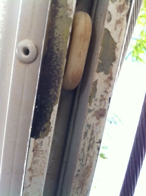

photo of gooseneck external slide
Hi Trina,
I don't have the part so I can't post a photo of it. Here is the photo of the slide that it does in to.

Ed,
I'm assuming that that your O'Day 25 was built on the West Coast. O'Day used about four or five different spar manufacturers or suppliers back then and it's important that you find out what the make of your spar are.
Check out this site to see if you can identify your spars particularly your boom.
http://rigrite.com/index.htm
Try to get an accurate measurement on you boom. If worse comes to worse you may be able to change both of the extrusions and go with a different goose neck fitting altogether. I'm assuming also that the mast is set up for a tack down haul. Usually there is a jam cleat attached to the mast track just below the gooseneck fitting for this purpose.
My gooseneck fitting is riveted to my mast. I have no tack downhaul.
Good luck!
