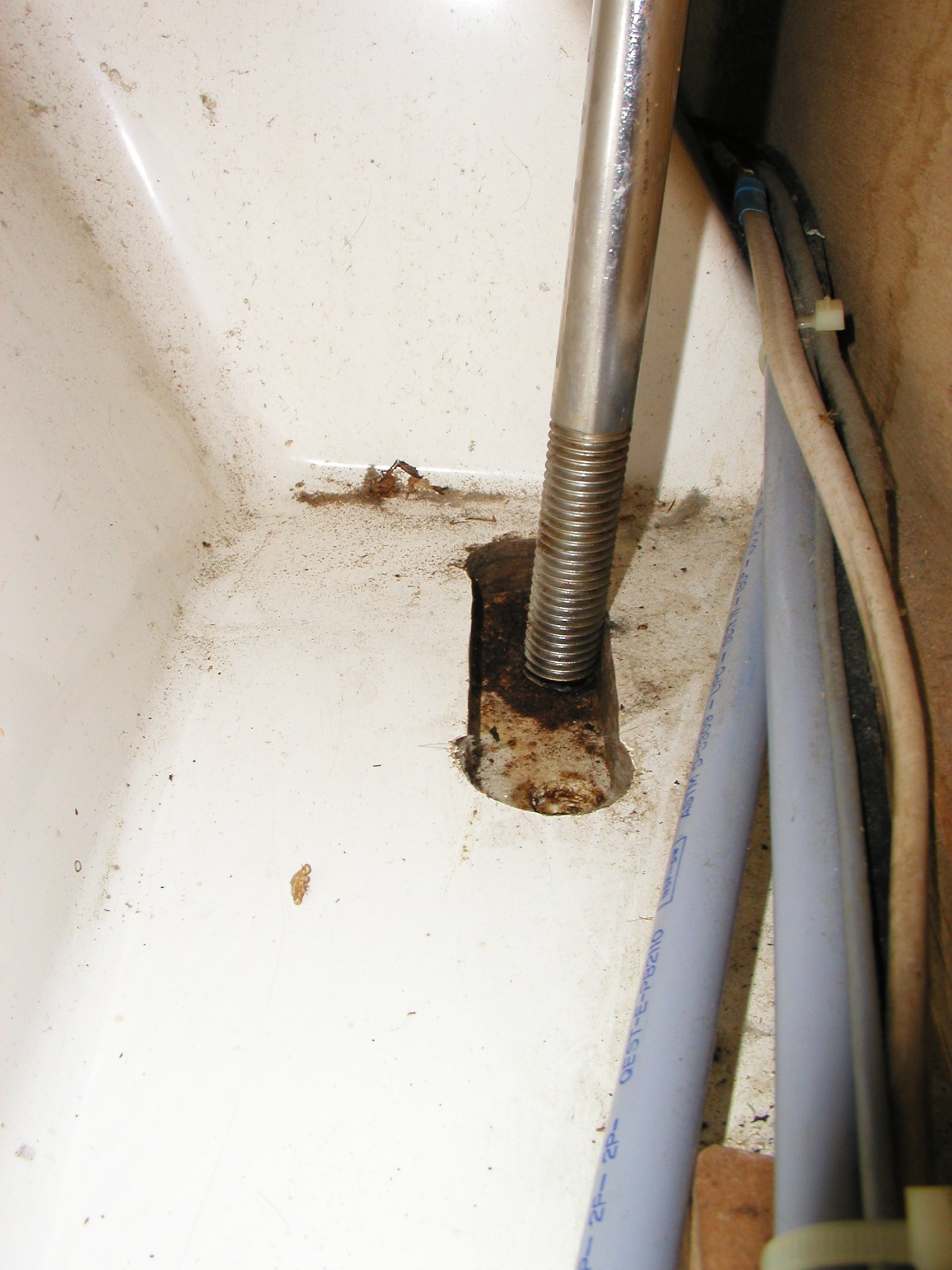

Here is a picture of the starboard tie rod attachment/anchor that I mentioned earlier, in the cubby over the table :
The anchor that the rod is screwed into is a piece of carbon steel angle iron that has a nut welded on the backside. If the deck plate part of the rod leaks, the anchor can rust out to the point that the rod pulls out.. Surface rust is OK but use an ice pick to check for solid metal. If you can put the pick through, ya probably should not put the sails up..
