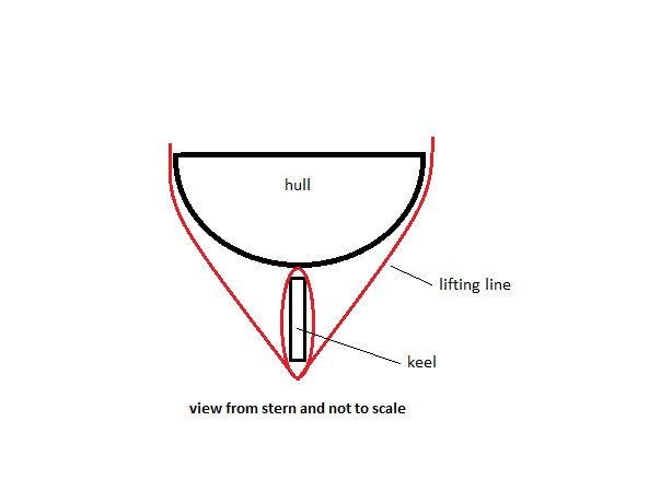

When mine broke I wrapped a line around the keel (towards the end), making a loop with the bitter ends and cross over at the bottom or forward edge of the keel. I used the jib winches to haul it into the trunk, alternating winching little by little on each side until it wouldn't go any further.
I was getting out of shallow water and back to my moor but I think this should get the keel high enough for a trailer.

Thanks for the reply. I like the idea of using the jib winches to bring up the keel. How did you attach the line to the keel? Did you dive into the water to attach it?

Yes, I made a loop in the line with the middle of the loop on the back side of the keel so that when I pulled it up the line didn't block the keel from entering the trunk. Kinda like this:
