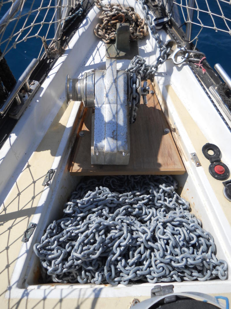

Additionally, again from the pictures, I found two or three issues that make me a bit wary. One thing is the anchor locker that has been (gross, in my opinion) modified to accommodate an electric windlass, the locker hatch being more or less brutally ripped off.

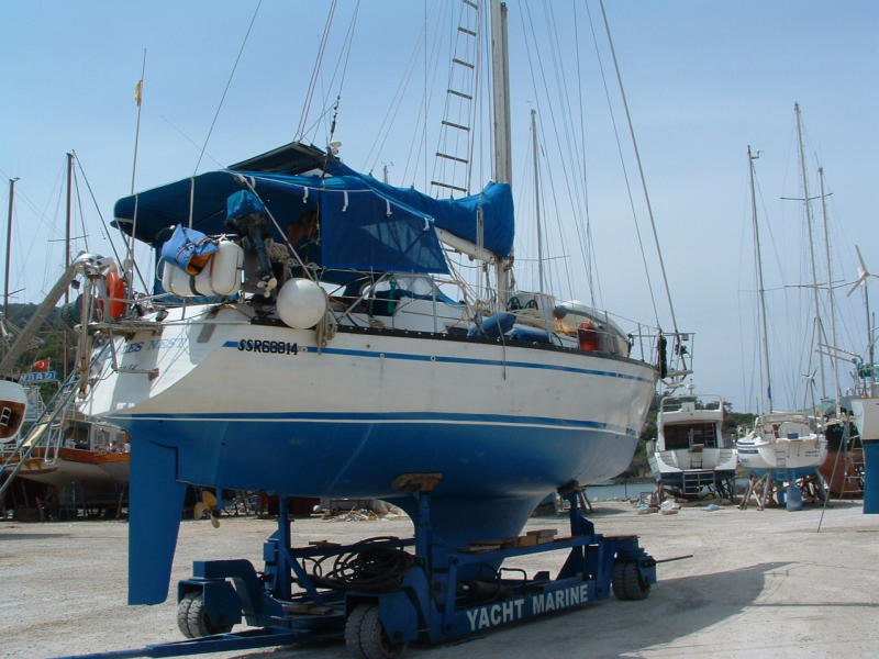

In one image I suspect a weak body, have a look at the post behind the keel:
Does this look like a dent or bulge to you as well?

that boat has a lot of extras on it making it very heavy and may have caused the dimples on the stands you can only expect so much support from one spot .......or the stands may be too tight to the hull .....it only took one more straw to break the camels back

so you think the dimple might be a structural problem, or "only" mishandling during transport without further negative effects?
I know the question cannot be answered reliably, I just want to read some other thoughts (than mine).
Sep 15, 2009
6,244
S2 9.2a Fairhope Al
only when you get the weight off that point will you know for sure i have seen this before and 99% of the time it pops back out without further problems just check that area inside and out after the weight is off ...if no cracks you are probably good to go

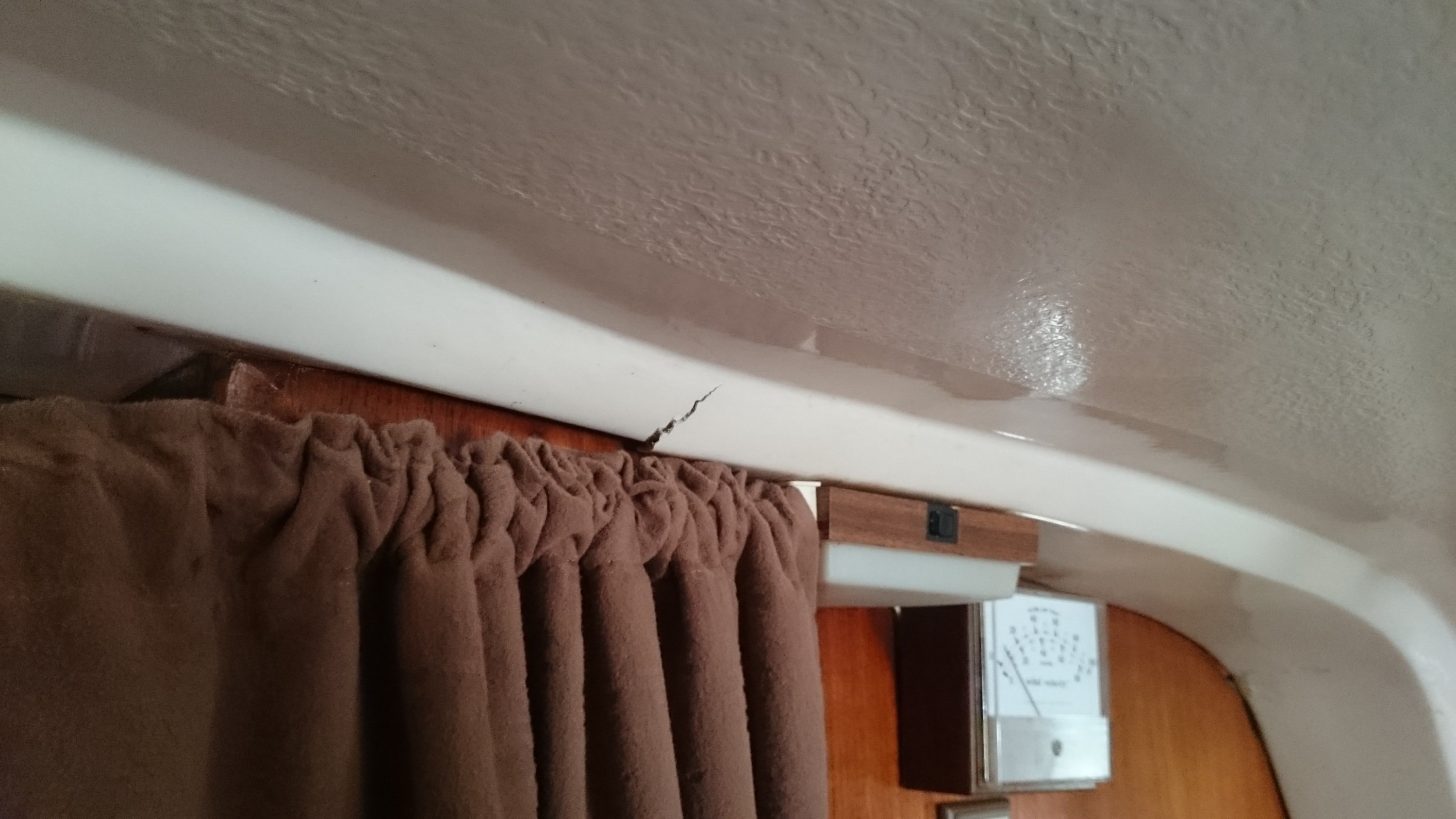

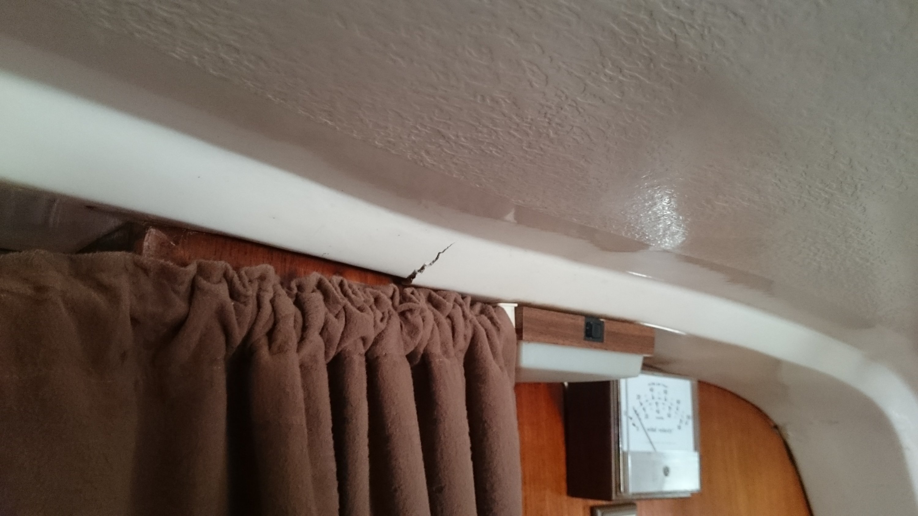

The cutter rig took its toll to the hull. A lot of stress cracks emerging from the bowsprit, the forward bulkhead building extremely visible pushouts. The mast step sunk 1-2" so that the inside of the deck has already cracked (see photo). Although the boat is already half a year out of the water (or more) there is a lot of water in the bilge, the still wooden mast post must be rotting without end.

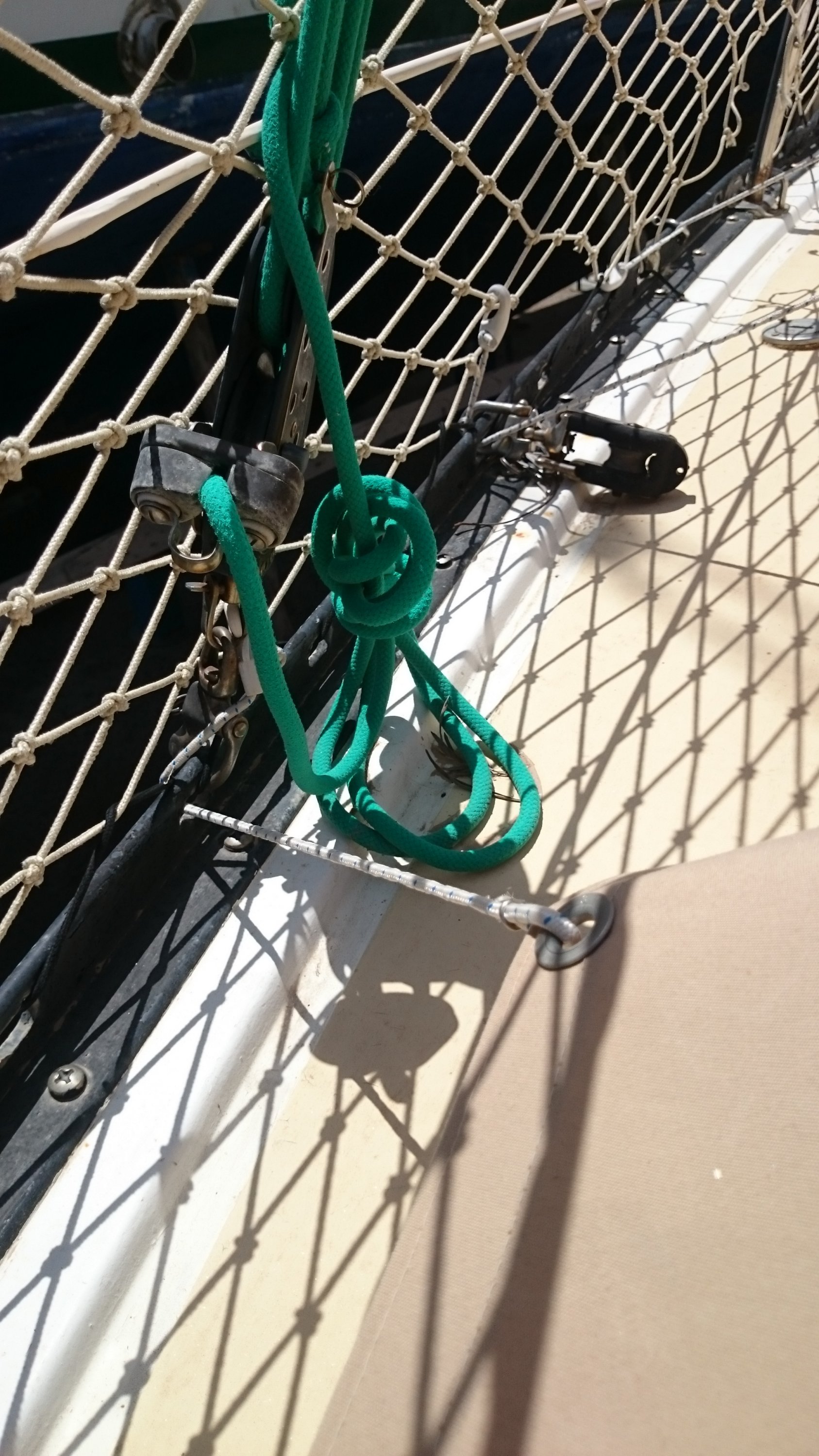

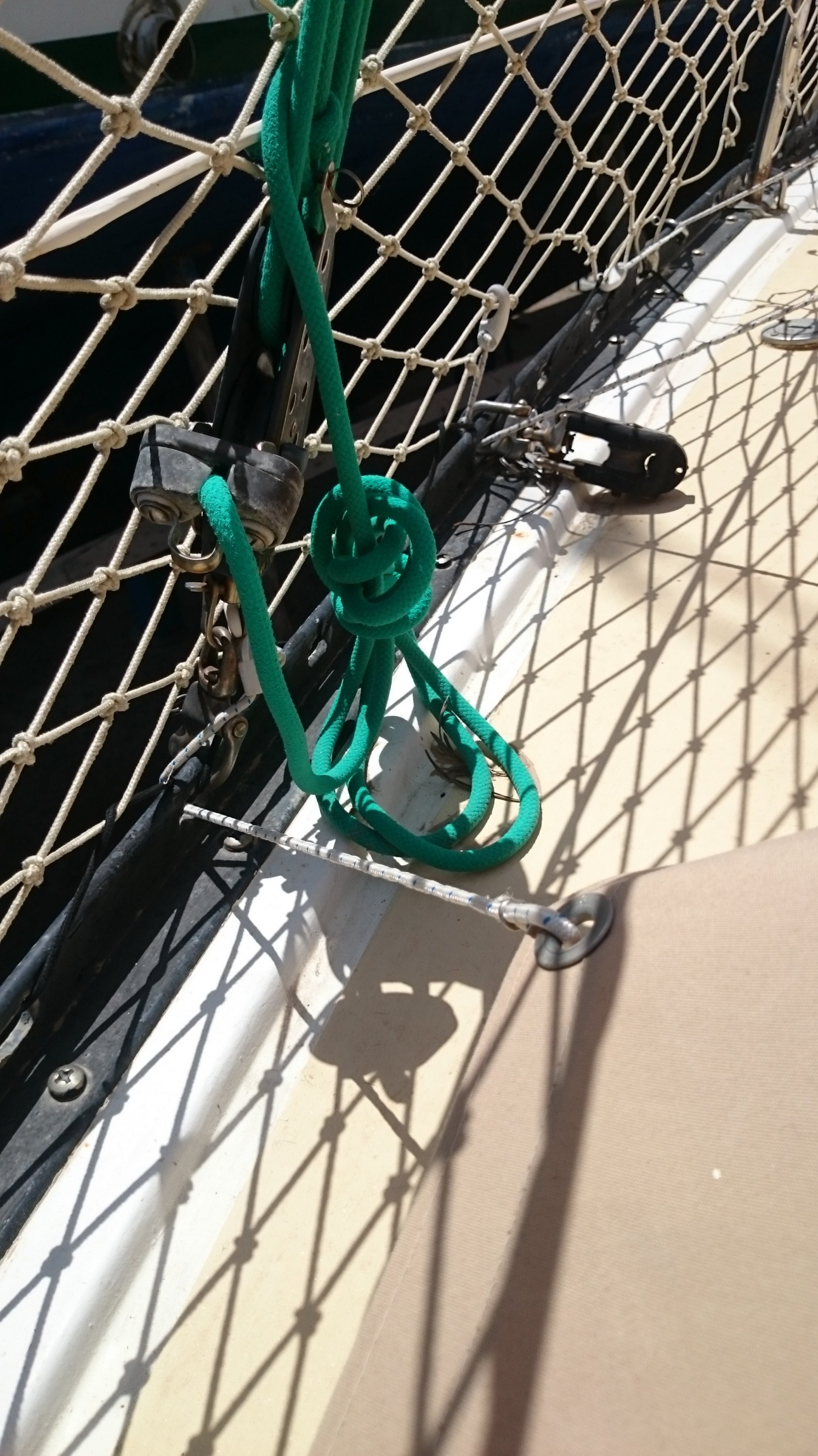

The running backs are fitted to the toerail - never saw something similar...
