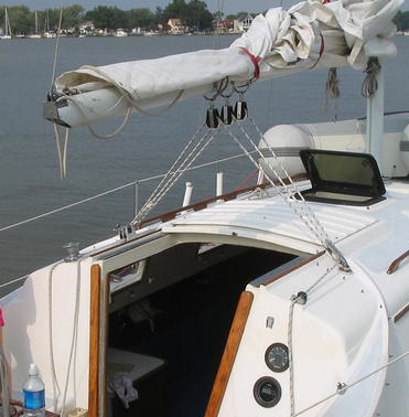

The h27 Cherubini came with two different cockpit configurations, one for tiller and the other for wheel. The one for tiller came with two full cockpit benches while the one for wheel sported three benches, two short and one aft. The space division between the forward benches and the aft allows for walking around the wheel or for the installation of a larger wheel. The aft bench also serves as the helmsman seat. I'm not sure a conversion from one steering system to the other would yield satisfactory results in either direction. I can see where moving the mainsheet forward would make life in the cockpit a whole lot more comfortable when underway. The best configuration would be to add a traveller to the cabin top. The original booms used for those boats were overbuilt for the small mainsails used and can easily withstand the forces of a midboom setup. The real power in those boats was provided by the Genoa. The main sheet factory setup had three boom bails spaced apart at midboom with a block attached to each bail and blocks at each side of the cabin stringed with the mainsheet in a triangular way to povide purchase. It is a very innefficient system and that is why many have converted to a traveller. I;m sure some members can post some photos for you. Good luck.

here's a picture
I tried cropping the picture a little to hopefully make it easier to see the boom bails and the cabin top with the blocks on a spring base.

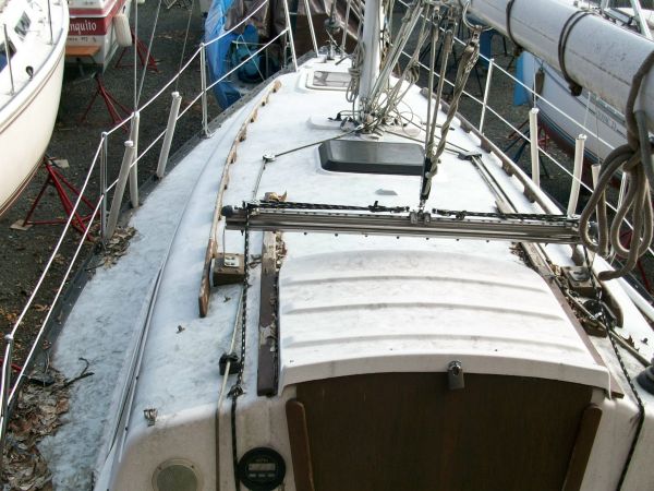

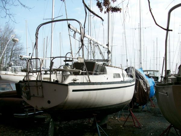

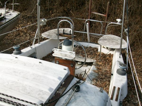

Great replies! Thanks! The pics of the rigging setup are useful. As for those who think the main sheet aft is still preferable with wheel steering, I'm not sure there is room to do that on a 27. The main sheet traveler is right where you would want to sit and if you could move it aft further you couldn't move it aft enough to keep it out of your hair. Maybe I am not picturing it right in my head but it doesn't seem to be doable that way.

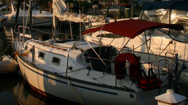

So where exactly is your traveler right now. You are converting a tiller H27 to wheel steering, right? I thought the traveler was on the bridgedeck, the step into the companionway. Here is a nice example of a conversion: http://www.sailingtexas.com/shunter27103.html .
Jun 2, 2004
5,802
Well that picture certainly explains your desire to move it. I had no idea that Cherubini ever did that. Where is the end of the boom in relation to the traveler? The boom must be quite long. This would seem to indicate that a traveler ahead of the companionway is forward of mid-boom. Then you will need at least 6:1 or better for any control at all.
