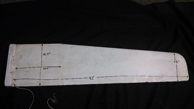

I recently rescued a 13' Banshee from a saws-all.It came to me in pieces.I was hoping some one could tell me where I could get an owners manual or some drawings for the rigging.I need to make a new dagger board as it is missing. Thanks, Skip

I have been tinkering with a hand me down Banshee in my garage. The main trunk of the dagger board where it passes through the hull is 7/8" thick. The board looks like this. Feel free to ask anything else. Good luck on your project.
