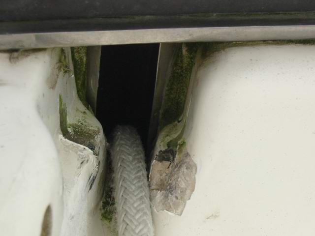

Help! The sheave and pin where the centerboard line turns down into the mast on H26 went flying overboard Saturday. I was cranking up the cb and apparently the fiberglass which supports the pin failed, allowing the pin and sheave to get sqeezed out by the high load on the cb line.How should I go about fixing the fiberglass so it will be strong enough to support a new pin and sheave? See photo.Thanks in advance.Ron Mehringers/v Hydro-Therapy
