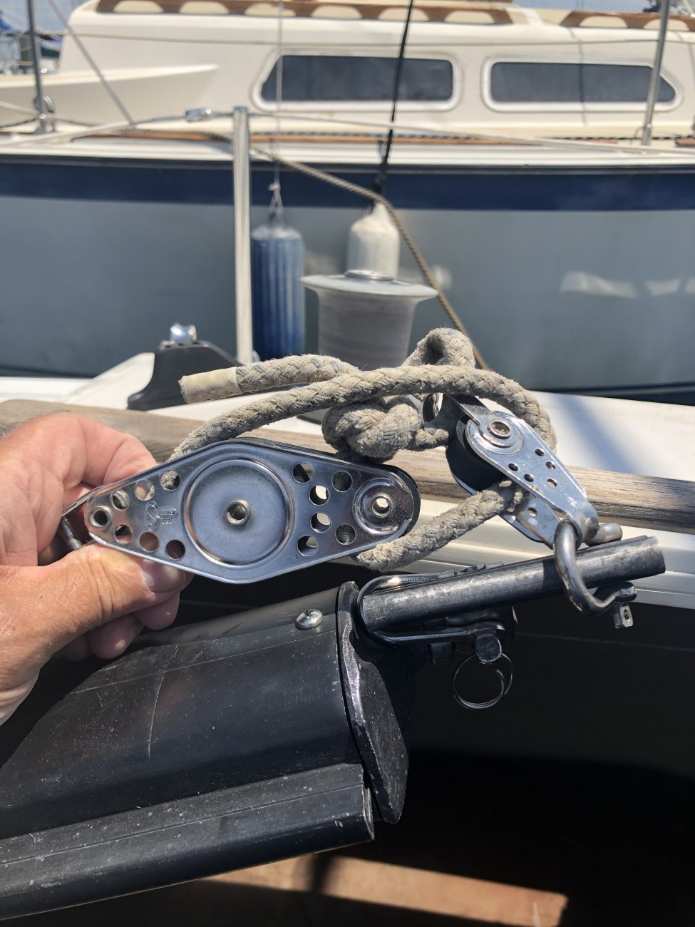

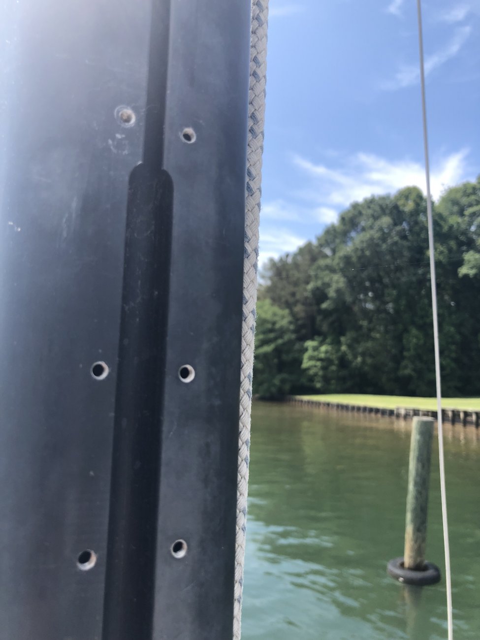

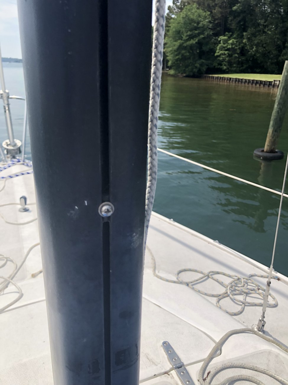

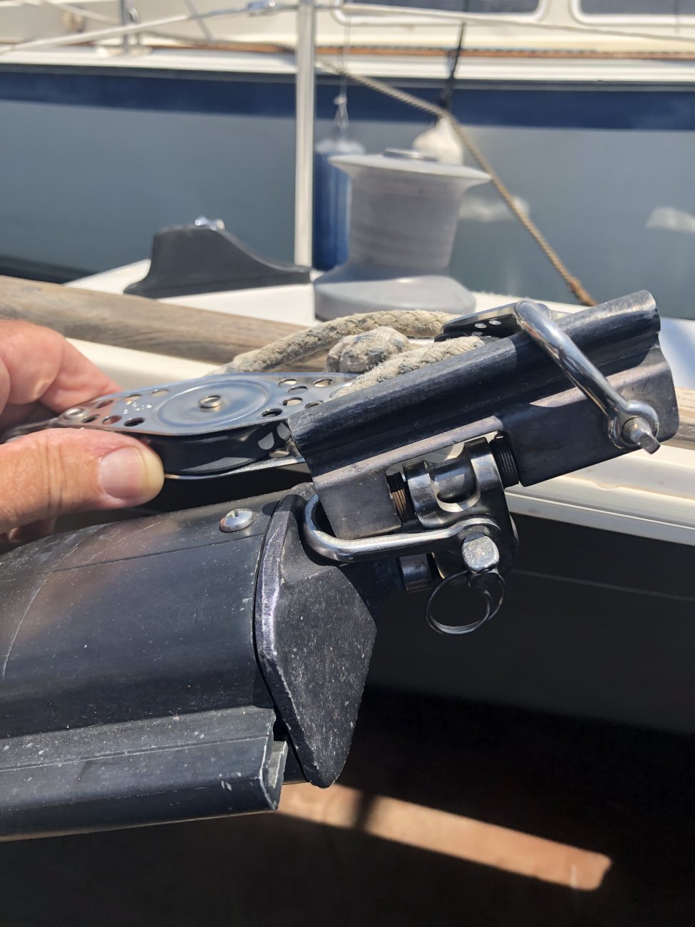

Time to update. I understand the boom is supposed to slide up and down in its channel. My question is more about the mast. There’s a large slot to insert the boom gooseneck. There are about 8 holes around this slot as if some kind of plate is supposed to be attached. I posted a picture. Far below that is a screw. Is this to prevent the boom from sliding down too far? I attached a picture.

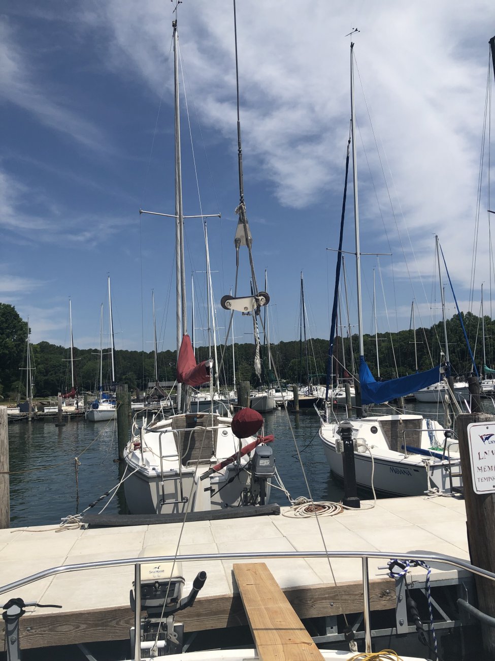

I also attached pictures of the gooseneck assembly and the back stay. You can see it’s a split back stay. I assume the little carriage assembly is to adjust tension on the back stay while you’re sailing.

The boom is connected to a gooseneck that can be fitted in the mast track, but you should rig a downhaul to hold it in place at the least. The gooseneck is commonly bolted in place at the limit of the luff.
