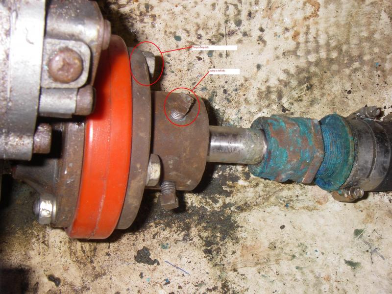

You are most likely going to have to remove 4 coupling to coupling bolts (see picture) and 2 coupling to shaft bolts. Once the couplings are seperated then the shaft can be pressed out of the aft coupling by placing a socket or something of suitable size in there and bolting the flanges back together.
This is not the time to try and be quick. Do not hammer on things or do anything that transfers the forces to the strut or transmission bearings. Lube and wait if necessary.

I did this project a year ago. First use some PB Blaster and let it sit for some time. Remove the 4 flange bolts and pull the shaft back enough to get a socket between the flange and the transmission. I forget the size, maybe a 7/16 th. Get 4 longer bolts and place them through the flange and the transmission. Put the nuts on and slowly tighten the bolts a little at the keeping the flange even. Alternating the tightening is the key. Not a bad time to replace the nylon stuffing box and hose while you are at it.

Apply PB Blaster on all the bolts nuts and in the shaft key way. PB Blaster is kind of like liquid wrench but MUCH bette. Do this several times over a few days. Each time you use the PB Blaster tap the coupling all around with a small hammer. This helps the PB Blaster to penetrate and loosen things up. Cover the end of the transmission with a rag when you spray the PB Blaster so you don't get it on the transmission oil seal. The PB Blaster can damage the rubber in the seal.
After 6 or 7 applications of BP Blaster over several days (time is your friend and allows the PB Blaster to work) and some gentle tapping remove the safety wires and back out the 4 bolds on the shaft. Then remove the bolts between the coupling and the flange on the transmission. Slide the shaft back and insert a socket from you socket set between the coupling and flange on the transmission. The coupling and flange should be about 1/2" to an 1" apart. The distance will depend on how far you can back out your shaft before the prop hits the rudder and the size of the socked you can get in there.
Insert 4 slightly longer bolts and nuts and washers joining the transmission flange and the coupling. Tighten them down a little at a time and the coupling should start to back off the shaft. If not you can use a little heat from a plumbers torch. BUT BE CAREFUL AND HAVE LOTS OF WATER NEAR JUST IN CASE. Use the water in case of fire. Don't use the water to cool hot metal unless it's an emergency. The sudden cooling will make the casted coupling very brittle and might crack it.
Once you've drawn the coupling and flange together is the shaft is not loose you may have separate the coupling and flange and do a second or third round with a larger socket.....
Be careful because if you break the flange on the transmission you'll be in deep do do. This will probably work but you may wind up having to cut the shaft and replacing it.
