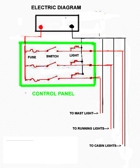

Funny what some people do. I bought a 1987 26D this summer and also need to do some re-wiring. The previous owner installed a bracket for a depth sounder on top of the pop up hatch but the wires are too short so I can't raise the hatch all the way. There is no battery but I assume it goes under the sink as the panel is there. Does your boat have a holder for the battery? There is nothing on mine. Do you know if there is a wiring print for the boat? I would like to re-wire the whole thing too. Karl
Jul 7, 2004
8,480
Hunter 30T Cheney, KS
This is it. No frills. A sailor should be a lot more more creative in designing a system that's practical
