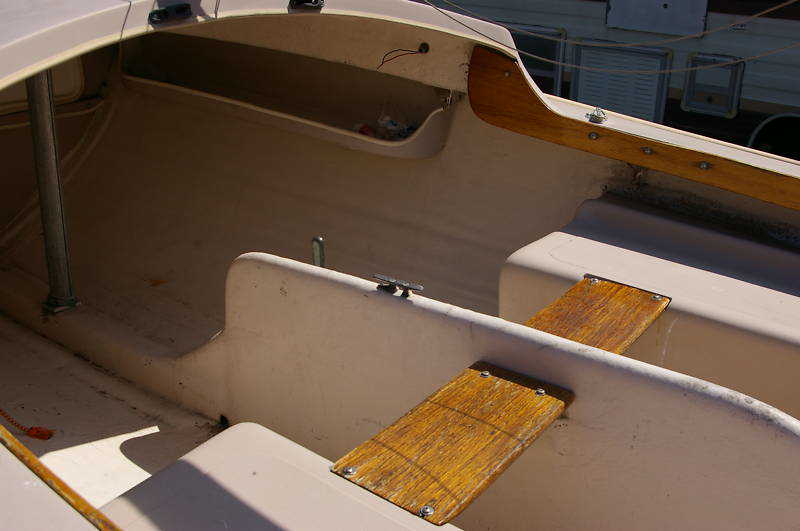

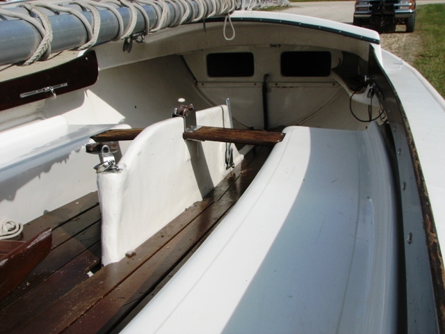

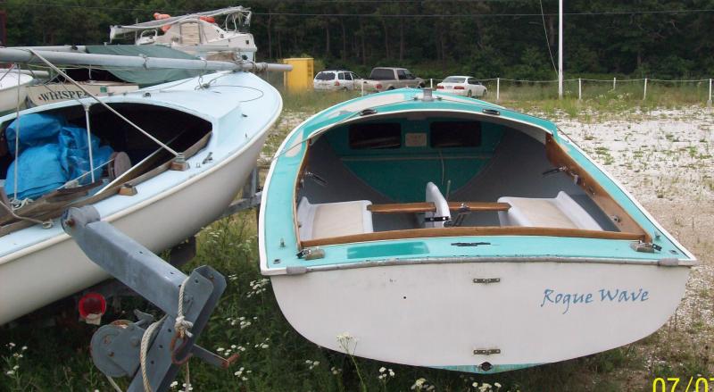

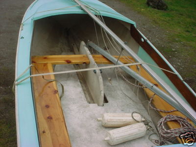

Well, from your description, this is an O'DAY Day Sailer I (DS I), I had to laugh when you mentioned the "Aft sink-cooler", although O'DAY did say it could be used as a cooler (uninsulated!) to keep your drink cans cold, the primary purpose of that molded box is to allow clamping an outboard directly to the transom. Build year could be anywhere from 1959 to 1976 if built by O'DAY, most were between 1959 and 1970 (DS II introduced in 1971, but DS I still built as special order for a few more years). If the seats are wood, then she would most likely be a 1959-61 model, later years had fiberglass seats. All years of the DS I did have 2 short wood seats that braced the CB trunk to the seats. However, the "kicker-pit" (outboard mount/cooler) wasn't added until about 1962.

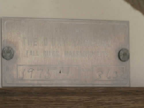

Most of the DS Is were built prior to the 12-digit Hull ID Number requirement that began in November 1972. O'DAY boats built prior to that had a little metal plate riveted to the forward flotation tank (on the DS I) that would have listed 2 numbers, a HULL# and a CLASS#. But if your plate is missing........ I don't think O'DAY marked those numbers anywhere else on the boat.

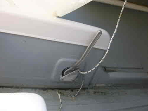

I'm curious how she sails having a keel instead of the original centerboard, is it a fixed keel or retractable? I would think a fixed keel would make trailering harder, but the added stability might make up for that. If the keel is retractable, make sure that the centerboard trunk has been braced well to handle the added strain of the heavy retractable keel, it was originally designed to handle the original 25# centerboard (lever-operated) and so may flex more with the heavier keel.
