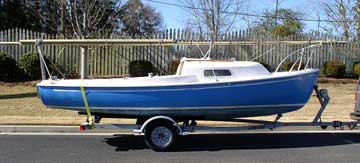

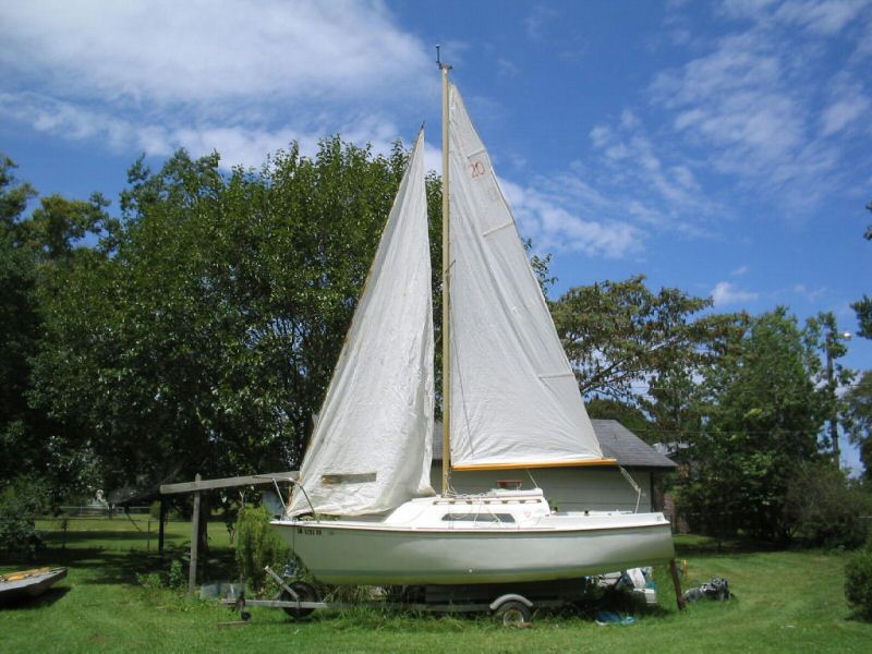

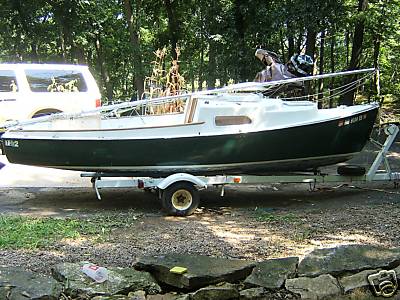

The O'DAY 20 came out in 1973, so if yours is a 20 she would be 1973 or later. D&R has the spreaders, but Rudy will need to know which type your boat has, the model year usually is an indication. DWYER Spars in Connecticut is another source, but D&R will supply the exact length without needing the old one to measure.
I'll add a picture of the 1973 O'DAY 20 for reference, you mention "2+2" so I wonder if you actually have a 19' MARINER instead of a 20? I'll add a picture of one of those (actually 2, because O'DAY phased in a different deck design on the Mariner during 1972).
The Mariner rig spreaders were pretty much the same type for all model years, but Rudy can advise.

So the blue is the mariner 19, probably this ... the only things Im sure is what is write on the plate "C/B 2&2". For the year its just by memory of a old man.
Thx for all the info
