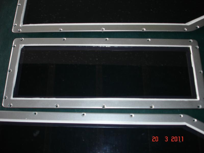

I removed and restored my fixed ports a few years ago.The details are in the Modifications section. Looks like the same kind of frame.

Richard article above was a huge help on removing the windows, exactly as described.
I cleaned the heck out of the windows and decided to go with butyl tape rubber to attach the frame to the deck.
First after removing from the boat I put plastic over the holes, and took the frames to the local glass shop and had them make a custom piece of Lexan for the frame. Next I took the rubber and frame to local custom shower shop and they had the exact rubber for the frame. I one piece of rubber in the frame all the around. Not sure if my outer frame was broken but it was 2 pieces.
I ordered butyl rubber from:
http://www.pbase.com/mainecruising/butyl_tape
I put 2 strips of butyl rubber around the entire outer frame on each edges that contact the outer hull and the inside edge of the frame.
Then I set the frame in place and before putting the bolts, carefully slid in the tight fighting lexan. I then put in the screws some of them were loose and just spinned. I went got a ton of screws some a little longer some a little thicker and some thicker and longer. Each screw had to really grab because you have to use it squeeze out the butyl rubber slowly takes several days of slowly tighting the screws do not do it all at once!!!!
Next I painter taped off the window and this is the tough part I used west marine clear silicon. You also want a spray bottle of denatured alcohol. To get a good clean look you have to be fast. It helps if you have 2 people and divide the jobs.
1.Put the a thick line of silicon all around the edges of the glass.
2. Peel off the tape
3. Spray the silicon with denatured alcohol.
4. Spray your finger and smooth with your finger you get one swipe, DO NOT GO BACKWARDS OR IT WILL LOOK AWFUL AND DO NOT KEEP MESSING WITH. YOU ONLY HAVE ABOUT 30 SECONDS.
***You will only need about 3/4 of the tube for one window practice on something small so you can see how silicon works again use the denatured alcohol works to stop the sticky***
I HAVE NO MORE LEAKS!!!!
