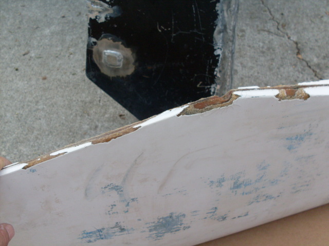

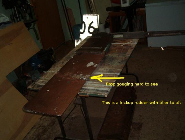

I wish I had pictures of my rudder before I fixed it. The PO had hit the rudder with the outboard many many times.
Oct 18, 2007
707
Macgregor 26S Lucama, NC
From the pictures I see, you guys have not had prop damage! When I got my boat, the PO had hit the rudder several times and chewed up the rudder, then ground it smooth again. The result was a rudder blade that, instead of being a long oval, looked like a bow tie. I built up the damaged area, filling in about 2 1/4" on the trailing edge, to the original profile. So far (nearly 4 years), I haven't hit the prop yet. -Paul
