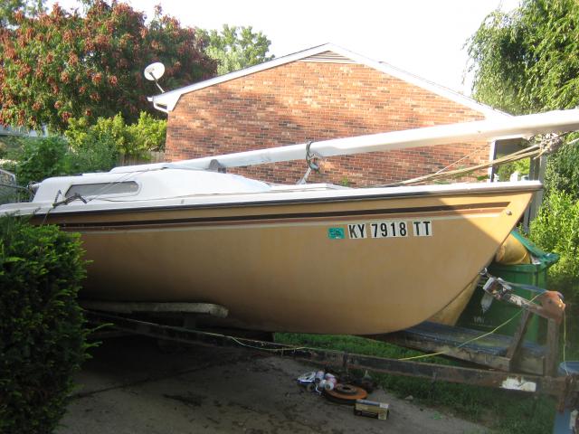

macgreger venture louisville,KY.
I have got a 21' boat that need a little help I know little about sailing and would like help getting my boat going. any help would be great.

first thing is to clean it, is it a swing keel? if it is if you get yuo trailoer level water will drain out of the cockpit. also reinstall a door on your cabin to keep water out. you need to make a mirror image of your hatch slip for the port sid also when installing use stainless screw and washers on both sides of the hole

Like JimmyB, I'm a bit of an ex-hotrodder myself and did much the same thing on my V21. Good advice already given: level the boat and trailer for the water to drain; pump out cabin and bilge after you set up protection/covers for hatch and lazarette openings. Once this is done you might get "lucky" and be trapped in the cabin during a heavy rain to be able to find any hidden deck leaks. Once you have that done, you can start really cleaning up and sorting out standing rigging which seems to be there(condition unknown from pic) already.
While I don't see your lines in the pics, I do see the board(possibly teak but could be made from other hardwoods) missing that goes accross the bunks at the hatch that holds up the keel winch.
Many old V21's were modified in their running rigging/sheets by previous owners and how you rig running lines may depend on what was already done to the boat. My rigging was all makeshift when I got it and I eventually recreated the original mainsheet system and ran lines to the cockpit as the seasons to sail went along.
