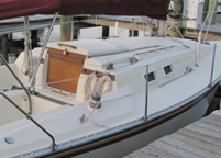

Welcome to the forum and congratulations on your new sailboat!!
Handrails: make measurement based on when the holes were or from another 25.5 or buy a 3 loop Whitecap teak handrail for $38 as shown in the 25.5 photo below that fits from this site: Whitecap Industries Whitecap Teak Handrails (sailboatowners.com) or from Amzon or on-line or local marine chandlery like West Marine and include screw hole plugs.
Companionway top sliding teak: Since it is custom you will need to fabricate yourself from teak, marine plywood glassed over OR starboard or acrylic sheet of the desired thickness cut to fit by your local plastics store. This thread discusses options for a new companionway hatch on a Hunter 25.5 ned help fabricating a new fiberglass sliding hatch for a hunter 25.5 | SailNet Community
