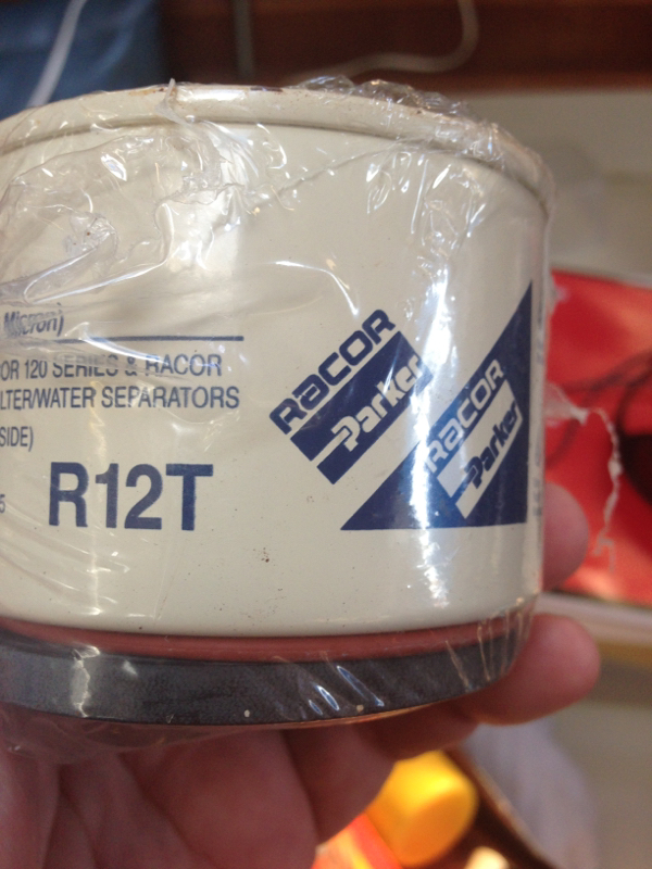

I have a 2GM in my '83 H31. I have a Racor R12T primary filter with the clear bowl, then a line from there to an outboard engine bulb that pushes the fuel into the low pressure side of the engine. It has worked great. If your engine is stopping after it runs a while it could be that your tank vent is clogged. That recently happened to me and of course the tank vent is the thing I check last, after changing both the filters. Also, there is a bleed screw on the high pressure pump its self that sometimes needs to be bled. I just looked at your link to the Racor filter. You don't need anything with that flow capacity. At full throttle your burn rate will be well lees than a gallon per hour. You can save money by going a lot smaller on your primary filter and still get the proper filtering that you need.
