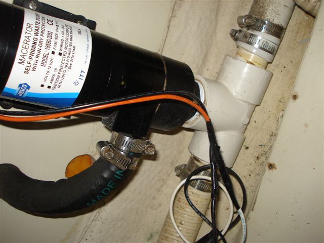

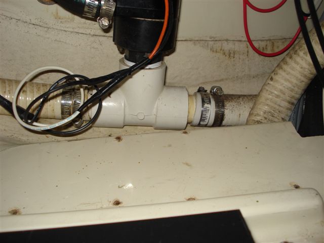

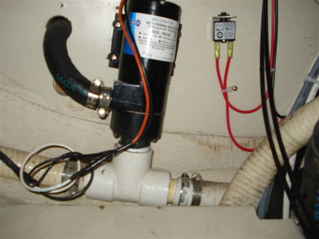

Photo of Tee at Macerator
Sorry for the delay with the photos my apology.
Here is my tee which is located on the bow side of the last stern bulkhead below the lazarette. My aft cabin has a generous access hatch installed when the tank was replaced. The vent can be an issue on our boats.

Any hoses that have turned that color should definitely be replaced...if they don't stink, they're so old that they've become so hard and brittle that they can start to crack. The black 1" hose coming off the macerator isn't even sanitation hose.
Fwiw, I would go with a y-valve, never a tee (boat builders use tees because they cost a lot less than y-valves)...'cuz tee doesn't provide any way to shut off the flow of waste from the tank to service the macertor pump...and macerators only need service when the tank is full, never when it's empty.

Thanks for your advice. I always enjoy your posts.
I will put it at the top of my spring list, from the ''bowl to the box''.
There is some dust on the pipes [in the hi res pic] I took so it might look worse.
