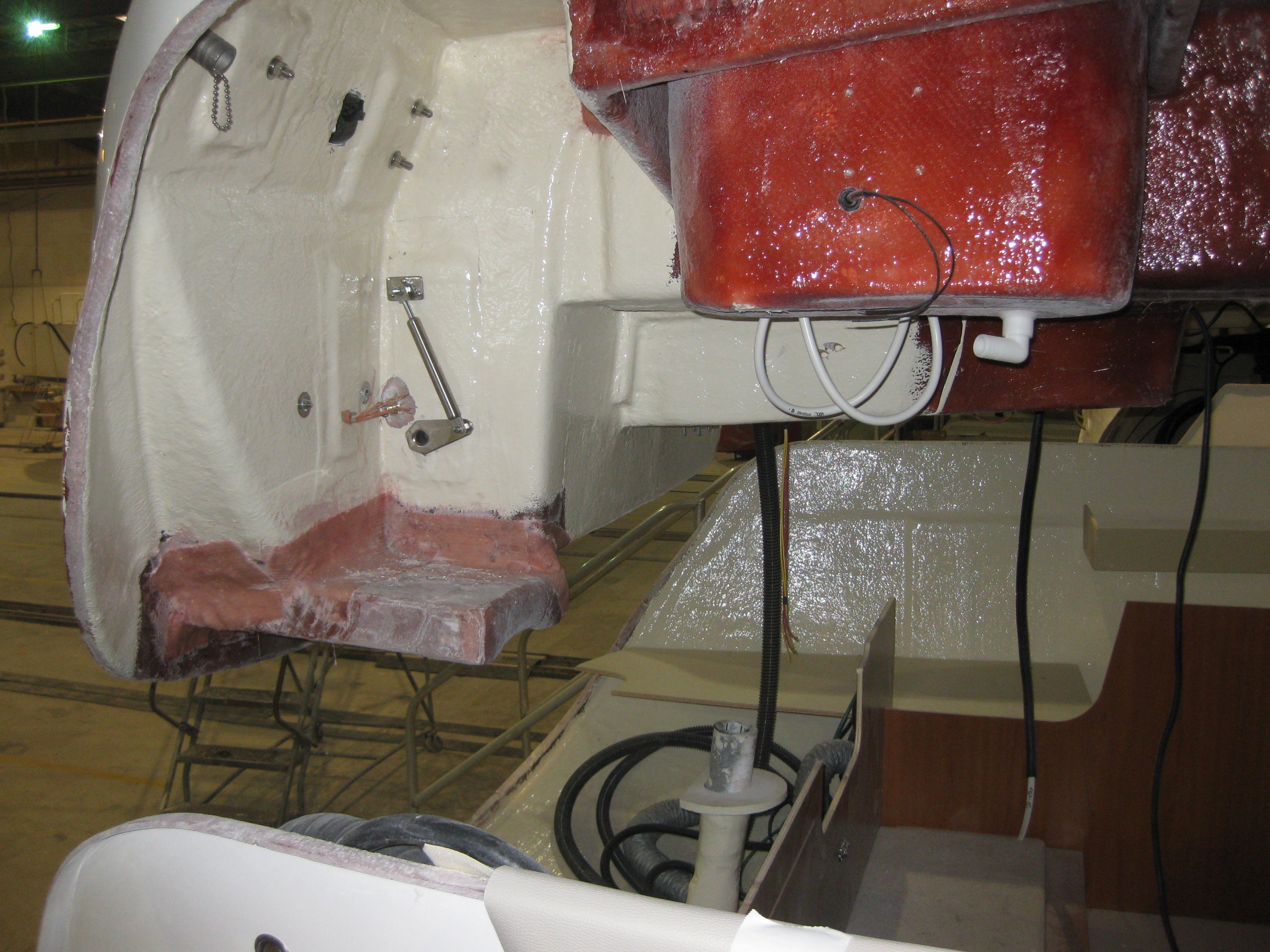

I would like to add dinghy davits to my 2012 e36. I know that there are many suppliers out there for davits but so far everyone I questioned has no clue what a Hunter e36 is. I would really like to find a supplier that has done davits for an e36. Has any e36 owner gone through this and if so who did you buy from?
The real issue is that there is no access (that I can find) to get at the inside surfaces that would be likely candidates for through bolting the davit supports. I am thinking that self tapping bolts with high strength epoxy should be adequate particularly if I mount the supports on the horizontal surface (lower transom step) since the load would be in compression.

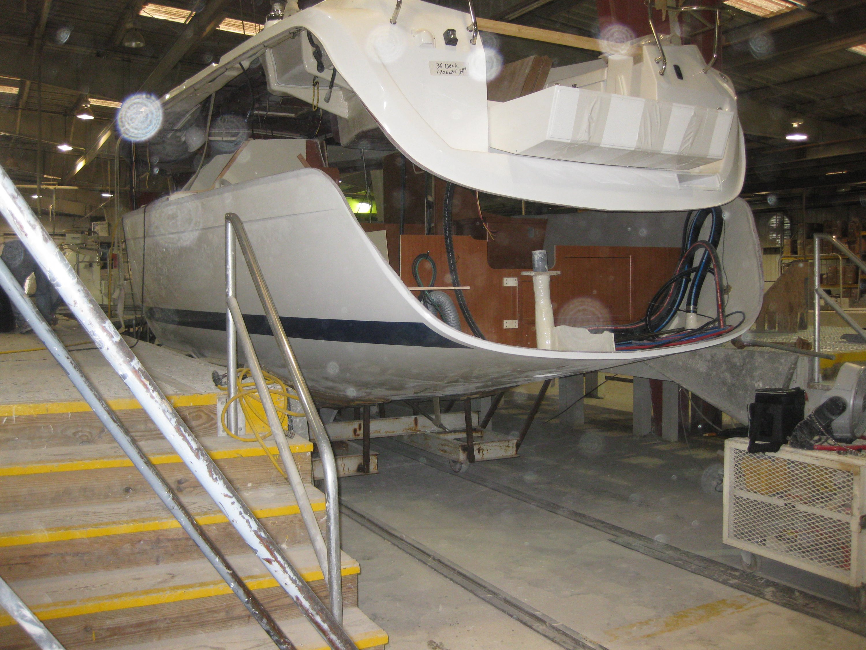

I am guessing the e36 has that wide step down transom and no way to get to inside for bolting
the bottom legs of the davits.
I have not seen this setup and just wondering if you sure you can't get at the inside transom from inside rear berth some how.
Do you have any photo's
Nick
21
Hunter 36 Burlington Ontario ON
Greg here are some photos I took of an e36 at the factory. There is access through the aft bunk and port side rear cockpit locker to the rear of the boat.

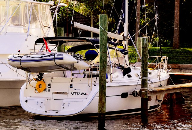

Greg, I'm not familiar with the 36e but I'm sure davits can be installed. The connection to the boat needs to be quite strong, dropping off a wave when heeled over puts a lot of stress on that connection.
We put davits on our 356 and would not be without them. They are high enough we can still use the helm seat, swim platform or guests can visit with the dinghy up. We often keep the engine on the dinghy when we lift it.
We bought our davits from Ocean Marine Systems (http://www.oceanmarinesystems.com) they used to supply the davits to Hunter and so had access to each new model. The company owner answers the phone and is quite knowledgable, probably worth a call even if you decide to buy from another supplier. I'm just a satisfied customer.

Neil, check out the photos on the site and the installation manual for the Ocean Marine davits, it has a number of tips in it, http://www.oceanmarinesystems.com/INSTRUCT.pdf
Our davits attach to the pushpit with a swivel block and then go straight down to sit on the gelcoat with a backing plate. The plates sitting on the gelcoat is quite small, about 1"x2" with two 3/8" bolts.
I don't have any good pictures of the davits without the dinghy on it. The picture in my post above is probably the best I have of how they attach to the boat.
