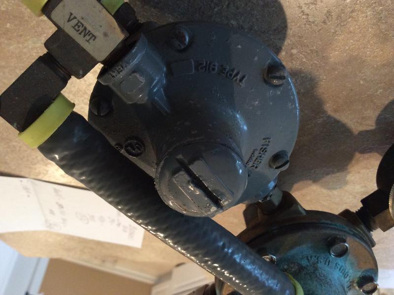

We are looking for a working secondary regulator for our CNG stove system. The regulator is a grey Fisher Co. type 912. Has anyone converted to propane and has this spare lying around???thanks.

That one is the low pressure regulator, there are two, a 3000ish psi to 300 psi and the gray one you describe which takes 300 to 13is inches of water column (1-3 psi)
These are standard regulators and you don't need a special one. Just have to make sure it will "go that low" and can be plumbed.
good luck

Check with Minney's surplus in Newport Beach.

Thanks. I'd looked yesterday and found nothing on eBay, but today I found an exact duplicate at a good price, thanks for all the suggestions. Great community of sailors, JT
