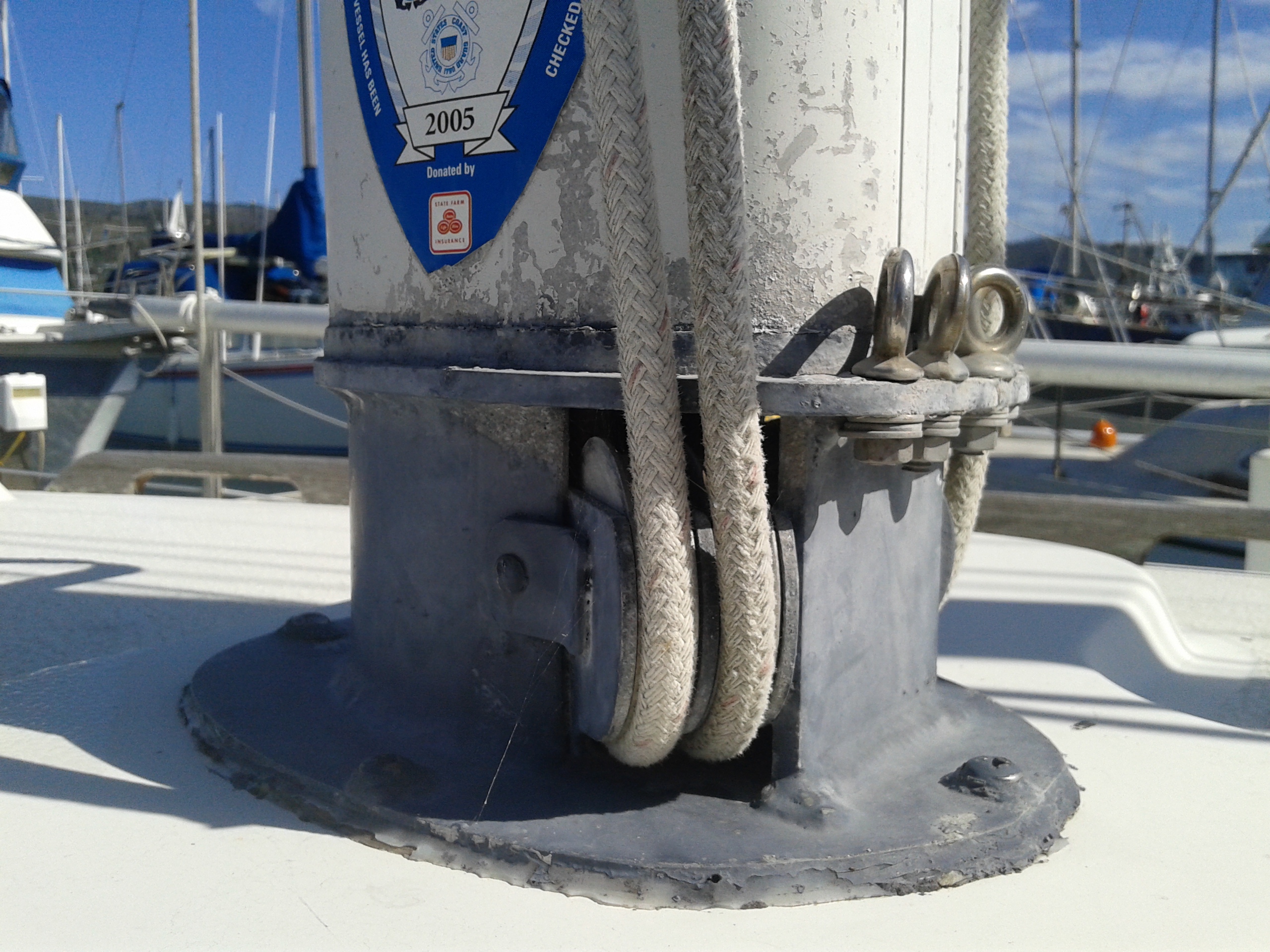

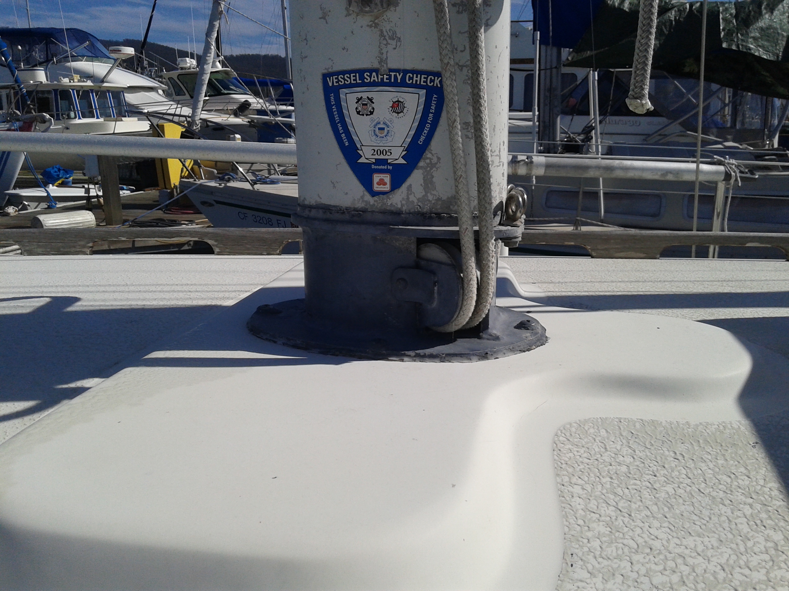

Hello friends, I need to pull the mast of my 1981 hunter 30 sailboat to do some work on the compression post and also to paint the mast and replace the rigging. I never done this before, can you please advise me how to proceed. I am going to use the harbor Crane which is not very high, perhaps the spreader will be as high as the top of the Crane. Attached is a few pictures of the bottom of the mast, are those 4 bolts need to be removed or the mast just sits on the deck ?,

now now. maybe 200lbs. and it is not difficult but it does take caution, and a simple understanding before doing. someone with experience will know the individual steps and helpful tricks look up on google the details. the mast will be slung by the crane at the spreaders. with the mast secured, stays are removed, theast lifted slightly, wires disconnected then rotated back. CAUTION the original questions do indicate little knowledge, so help is suggested. and to answer a couple questions.: the four bolts do not need to be removed, the mast sits on top, not bolted down. catalina 30 masts were mostly abodized aluminum, so look into need for painting before proceeding.

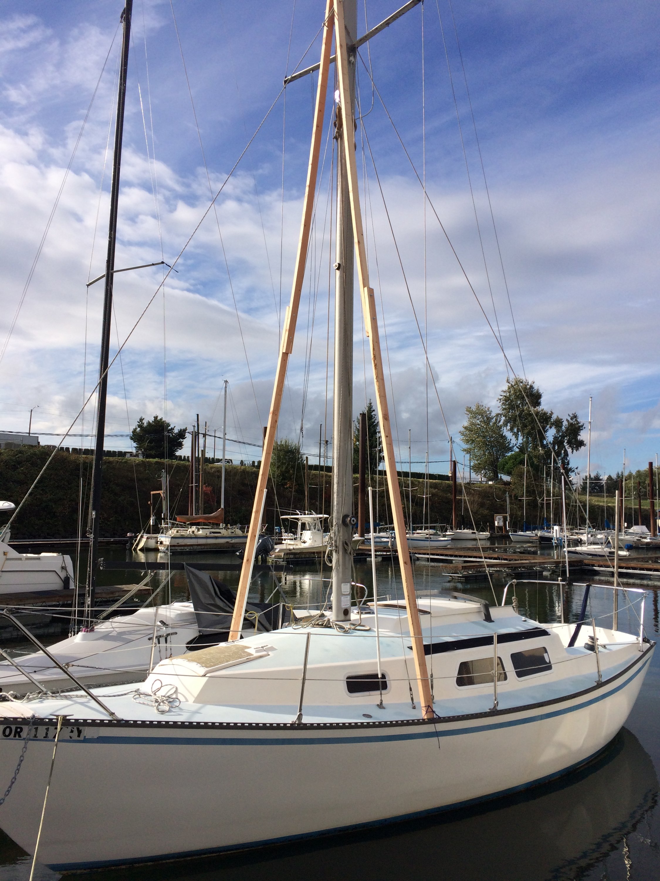

I just unstepped my 36' mast using a homemade A frame. It was not pretty to watch but it was effective, do some homework. Watch some YouTube videos, read some blog posts and find some hands which have done it before. The individual steps are not difficult just don't get in a hurry.
