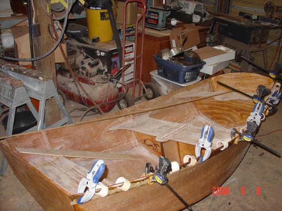

Almost finished building my hard pram dingy. Never really thought much about the proper (and safe) towing technique. How long is your towing line? Do you use a double line, one for each side to reduce side to side drift and overturning? Any ideas appreciated.....Gary

Can't tell from the photo but you will want to reinforce the bow eye if you intend to tow a lot. They take quite a beating at times. Also consider a towing bridal. Basically a loop of line that goes completely around the dink and pulls it from the rear. Use polypropylene line as it floats and does not get wrapped around the prop shaft. I tried the "make it ride the first/second wave of your wake" recommendation. The problem I ran into is that if there is any kind of wave action I can't even see my wake. I found that you have to just experiment each time you go out. With that said, I find that heaving the line to someone on a dock or a boat is when I need the most line. 50' works for me. Nice job on the fillets.
