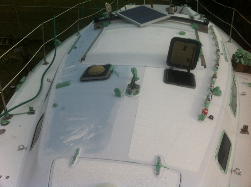

The challenge now: DECK LEAKS!
I have never owned a boat with so many leaks. All of the windows in the coachroof leaked, of course, so I ripped them all out and installed the plexiglass scab-on windows and that has cured the window leaks.
I know that this summer all stanchions will have to be pulled and re-bed.
The issue that is not so straightforward: leaks at the chainplates and some soft spots in the deck over the head that now seem related.
I just pulled the port main and lower chainplates and re-bed them perfectly. Also, pulled the head hatch and re-bed it perfectly. The main chainplate is still weeping below, inside the head. (I did not use sealant underneath the fitting, just on the deck) and it obvious that I have some wet core around the chainplate being fed by other deck leaks higher up.
I already knew that there were some soft areas in the deck between the mast base and aft of the hatch over the head, but sounding the deck around the chainplates during survey was solid.

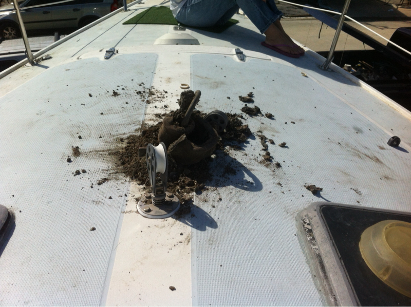

Here is a picture of the step on my Standard rig. I imagine it is the same as your tall rig. The step plate is held down by 4 lag bolts. The coax and wire goes through the deck that is sealed with a still flexible rubber compound in the center of the step. Their are junctions in both just above the deck but after 30 years I do not think the qualify as reusable.
When we dropped our mast it had 6" of bird poo collected at the base. Pretty nasty.

Thanks for the info . . . I didn't see the bird poop coming . . . thanks for the head's up on that!

ps. Wow, That is some serious bird poop!
