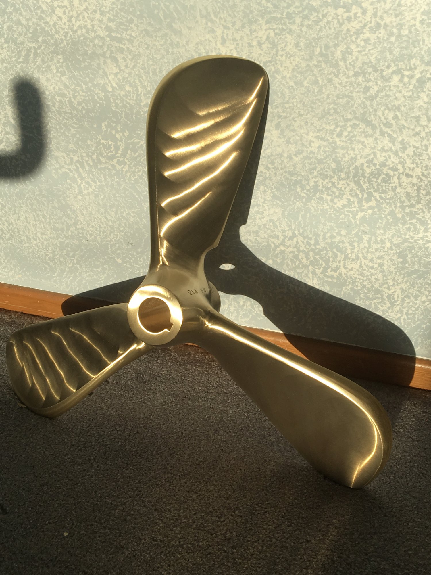

Our h36 came with a Yanmar 3YM30 and Michigan Wheel DJ355 (see attached). The MI wheel is a 16”, 9 pitch, RH fixed prop. Has anyone upgraded to a flexofold or Campbell sailor? If so, would you mind sharing the specs?

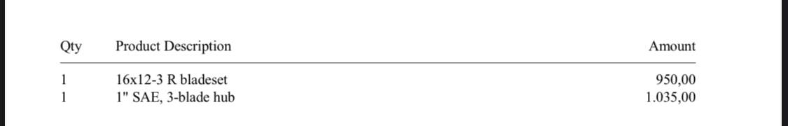

So yes, 08 H36 and replaced with Flex-o-fold 3-blade. Love it. I recommend you e-mail flex-o-fold directly, provide the info they need and they’ll spec the right prop. They’ll need to know your transmission specs, for example. 3,000 rpm is my cruise speed too. You didn’t mention whether your fixed blade is 2 or 3-blade, but I have a 3-blade fixed for sale if you were interested. My FoF prop is:
